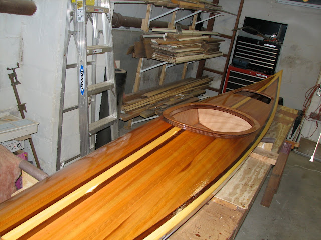

Thanks for the replys. I now have another question. After finishing the fiberglassing of the underside of the deck, I flipped it over and layed it in place on the hull. My consistent 1/8" overlap at the sheer is now as much as a  5/8" on both sides. I would hate to trim that much off the edge, because I have used (2) sheer strips of the same color, and I don't think it would look good. I am somewhat confident that the cradles I made prior to lifting the deck off were accurate. What happened here and how do I rectify this. Distressed in San Antonio. Thanks, Barry
The same thing happened to me. I believe the deck flattened some after I removed it from the forms. I glued mine down that way and ended up planing more off the edges than I would have liked. I suppose if I had strapped it better when I glued it down it would have returned to the right overhang. I also used a double edge strip which is now narrow in the middle, but I think it looks ok, quirky, but ok.
Well Dthaler, yours looks very nice so far. But I believe that with out any adjustment to the deck or hull I could be removing portions of at least the a width of a single strip. Strapping it down would seem to just compress things more without pulling the hull outward to meet the edge of the deck. What would you do at this point?

I'm not really sure. I found that the hull width did not change and is exactly to spec (probably due to the bulkheads). There may be a way to bow the deck back to the correct width before glueing, but I'm not sure what it is. Anyone?
My WD12 isn't a hybrid,  but its plywood deck also had a pretty good springback when it was released from the forms. So once I finished glassing the inside, I wired the forms back in. I used ratchet straps to persuade the deck to bend back around the forms. Once the deck was tacked to the hull, I took the forms out for good, then taped the deck to the hull.

Just spoke with Mark at CLC, and the consensus is that the hull itself has sprung in. The suggestion is to put some frames back in, tack the deck to the hull, and then remove the frames. Hopefully this will work. I will try this today, and let everyone know. Incidentally, I have found that the support I have been receiving from CLC has been excellent. Thanks to all.
I would like to post some pictures, but am not sure how to to that.
Just an update. I put the frames back in, and that solved the problem. The hull came back to the original shape and I spot tacked the deck on with hot glue. Then I reached in to remove the frames, glassed the deck to the hull, and only had to trim off about 1/16 -1/8" of sheer for the deck to become flush with the hull. That was my original overlap, so needless to say I was pleased. Today, I sanded the deck in preparation to start glassing.
