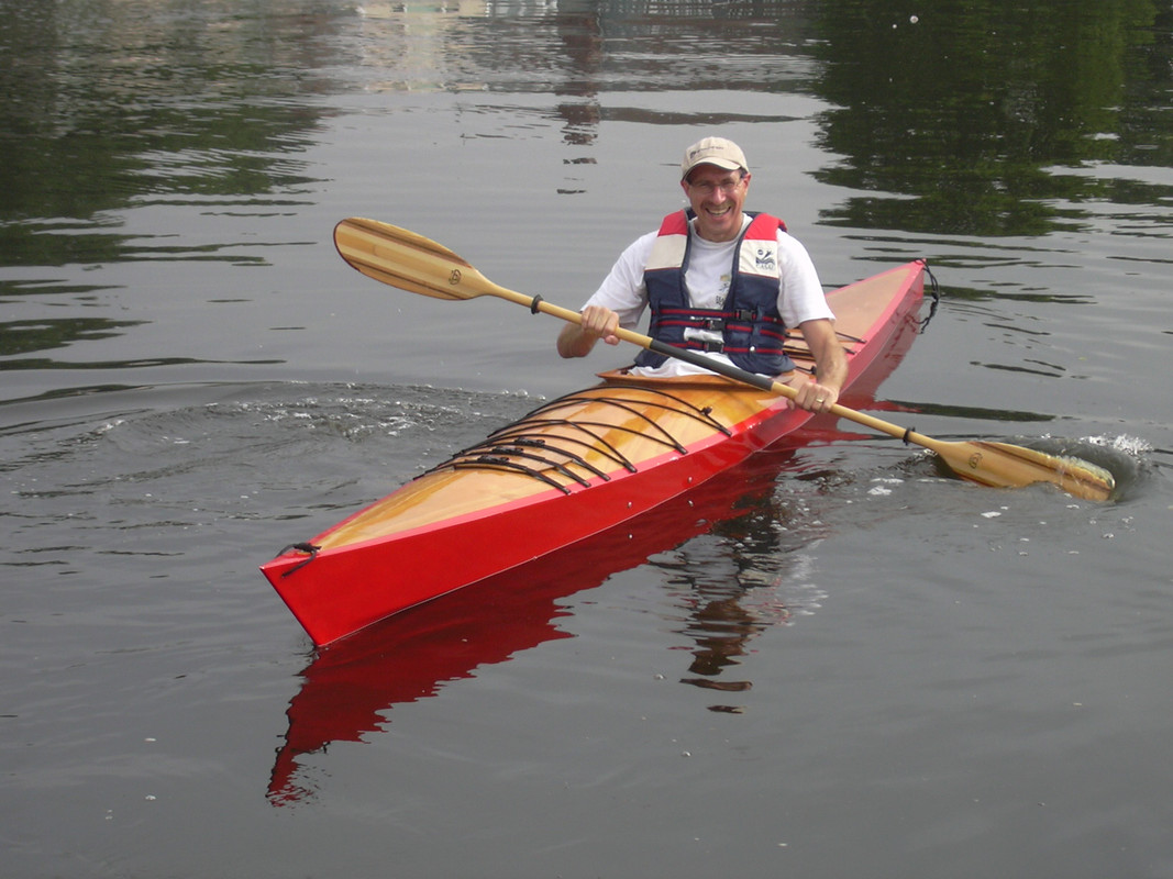

fwiw, the 17LT is a great first kayak.  i built three of them over the years.  i didn't do one bright, but here's one in red
interestingly, while i was out paddling today, i did bump into somebody paddling a bright 17LT, and it looked beautiful.
