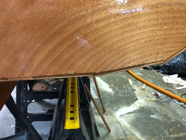

Discovered a mini-catastrophe in my PMD build.  Trimmed off the plank ends from the  transoms, and a few hours later noticed tiny pinpricks of what looked like moisture in the epoxy joints.  I dug into one a little bit with and discovered the epoxy in there didn't cure (after two weeks).  I must have not put enough hardner in, or failed to mix it properly.

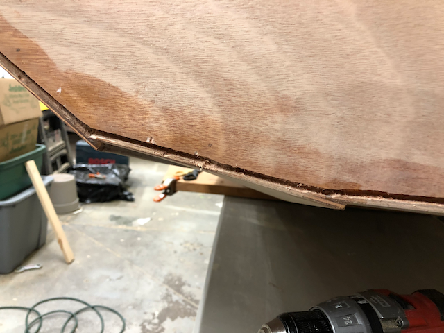

After I wiped away the tears I used a drill and 1/16 drillbit and probed all around the U shaped transom to find where it was mushy - about 70% of the way around.  Then I got out my dremel and a routing type bit and removed all the gooey stuff and most if not all of the soggy wood as well.  Gap is about 11/64" wide and as straight as I could freehand it.  Channeling my inner dentist I tried to keep going until the sawdust was coming out dry everywhere.
My plan is to wait until it dries out and then fill it up with properly mixed epoxy, clear tape it shut, and then sand tomorrow.  I was wondering - in case there is any goop-without-enough-hardner left in there, would it help to put some hardner on a q-tip and rub it around the inside?  Presumably if there was any wood-soggy-with-saturated resin, the hardner would react with it? Or should I just fill it with good epoxy and let that do its work?
First, you just proved that it was no catastrophe. You did everything just the way you needed to, cleaning it all out.
Your fix plan is sound, I'd only suggest 2 changes.
First, that could also be wet hardener in there if there wasn't enough resin in the mix, so adding more hardener could make it worse. I wouldn't do that.
Second, I don't know what the plans call for, but in light of this repair, I'd round the transom edge and put 6-oz glass tape all around it. It will provide at least as much strength as a wood-only joint and totally make up for any loss of strength from the mix mishap.
You're doing fine, you'll have a great boat and no one will ever know about this repair.

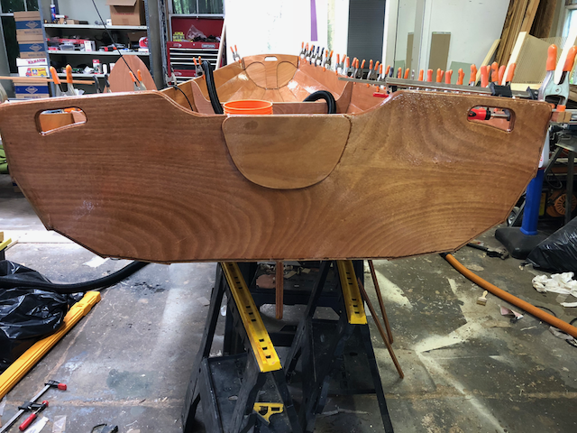

Just closing this out as I got past the place where I've epoxy-coated my transom, so it is as fixed as it will ever be and now sealed under plastic forever.
I routed it all out before John posted his advice, which I will follow next time.
After much consideration of Lazlo's advice, I decided not to glass over it on the outside, but i did glass halfway up the transom on the inside, and made some extra big fillets there, so I'm pretty confident it will stick together.
I'm planning to leave the transom bright and now just deciding whether I will leave that patch-job exposed, or possibly just paint so that it covers the joint between the strakes and the transom.
Thanks again for the help, gentlemen.
