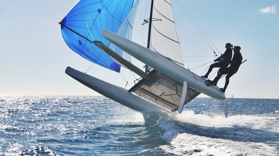

>>>Max Hull Speed = 1.34 X The SqrRt of Length of Water Line.
The "1.34" is the "speed/length ratio," and it's a variable in the equation, not a fixed figure. It's a reliable number for non-planing hulls with a length-to-beam ratio hovering around 2.5:1 to 4:1. Very roughly. PocketShip fits the description of a boat that ought to be sailing to a speed/length ratio of 1.34. However, with GPS in hand and witnesses aboard, I have observed it sailing at an S/L of 1.94. Clearly it was climbing up over its bow wave and starting to plane.
As hulls get narrower, "1.34" creeps up to 1.7, 1.8, 2, and onwards. Fast multihulls aren't planing, but are often observed sailing at S/L's of 4 or more. Madness has managed 3.65.
This tri is definitely NOT planing, but it's clearly ignoring the "1.34 X The SqrRt of Length of Water Line" rule!
Anyway, this is all somewhat academic and doesn't answer the question at hand. A kayak with the CLC SailRig is not going to sail like a Nacra 5.2, even with the big 70-square-foot sail. Just doesn't have the horsepower.
