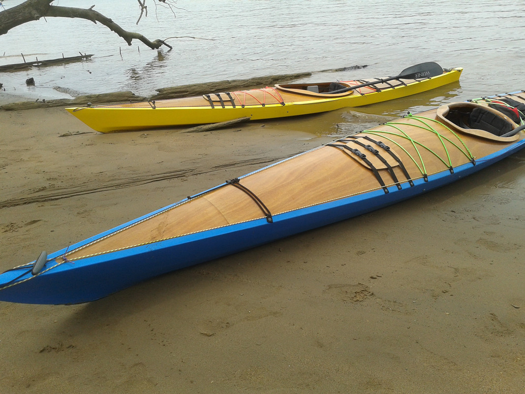

i also have a yellow boat....and yeah....lots of coats compared to green, red or blue, where its easily three and done.  i may have had as many as six coats.  i just took my time and one thin coat after another and eventually it looked solid.
   so to finish the thought, no seal coat is required....just let it bake for a while.
