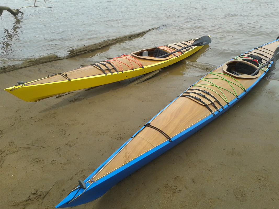

 below is a picture of my shearwater 17 ....do the hatches at least look like this from the outside?
Hi Kiyack14,
it looks like you were successful in attaching the picture above.....which already tells me a lot.  a couple more pictures - take one farther away and another where you have removed the hatch so we can see how you built underneath it would be really helpful.
based on what you have sent so far, its very hard to get a good seal becuase straps over the top like that don't create a lot of down pressure of the hatch into the gasket.  that said, there are way to improve the waterproofness of that kind of hatch and we can tell you more once we see under the hatch.
below is a picture of hatches attached with straps that can work,,,,
