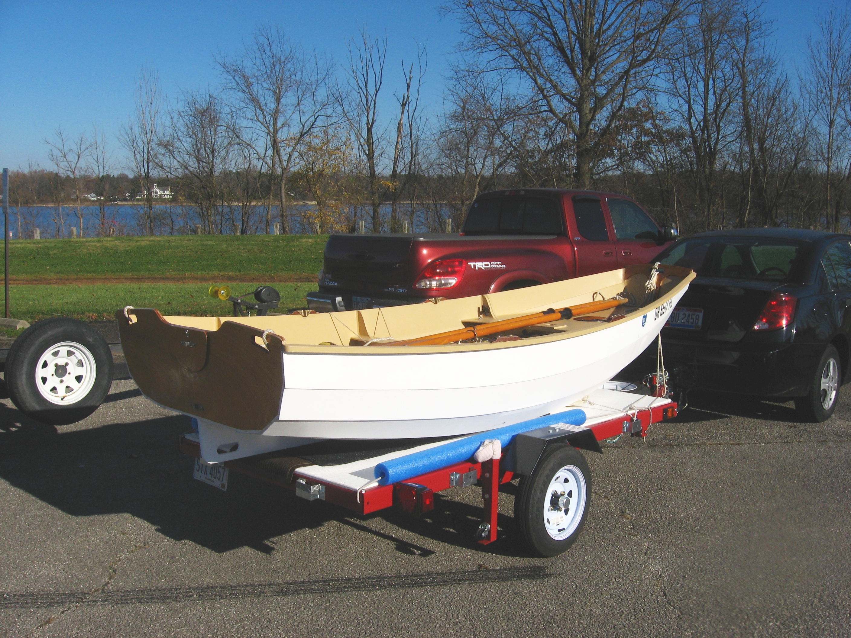

Finally got our Passagemaker Dinghy and trailer sorted out for a quick row Thursday to test the launching and recovery arrangements:
That's a Harbor Freight folding trailer from a kit, assembled by my son and grandson, with a deck from a 4'x8' piece 1/2" PVC, plus some Appalachian engineering by me to help get the boat on and off the trailer without tearing it up.
There was no need to dunk the trailer, either to launch or to recover, just as I had hoped.  The only parts to get wet were the lower parts of the wheel rims and tires (not the hubs) and the license plate.  The lights and back end of the trailer frame were all well clear of the water.
Went off easier than it came back on, but it wasn't difficult, really.  Pulled it off the trailer from the dock with the dock lines, though I could have easily pushed it off if there hadn't still been some of the floats still in at the ramp.  To recover, I carried a bow line to the front of the trailer with me, stood with feet above the waterline, and was able to pull her partway on from there.  She has a lot of rocker, she does, and the nose came well over the back of the trailer with her belly still floating.  Had to stand on the spare tire (mounted flat there near the tongue) to get a better angle and some elevation so I could get a hand on the bow transom grip to pull her all the way up, but it wasn't difficult.  Feet remained dry.  <;-)
Before we moved out of our old apartment with an attached bouthou...er...um...garage, I generally kept the dinghy disassembled (take apart version) so there'd still be room for a car.  I'd move the care, assemble the boat on some indoor/outdoor carpet, and pull her up stern first into the back of my pickup truck.  The pickup truck became surplus upon selling our Menger 19 catboat earlier this year, hence the need for alternative arrangements.  We've moved to much -smaller quarters, and the boat and trailer now live in a nearby storage unit, which, more's the Lord's blessing, was large enough to accommodate our surplus stuff and still leave room for the boat on the unfolded trailer, so there won't often be any need for disassembly unless I need to make room for coming at other stuff over the winter.
Hoping all this facilitates a lot of opportunity to get her out next season....
I might ought have mentioned that two athwartships ratchet tie downs seem to be all that is needed to keep her firmly on the trailer.  These are secured through the little holes in the brackets for side stakes on either side of the frame.
The line shown on the bow is just temporary to keep the boat from sliding off the trailer in launching and recovering.  The two pool noodles along the sides are to keep her from scraping on the fenders or other hard places if she twists on the trailer during handling.  I also padded the ends of the brackets for the casters (trailer can fold up and be tilted up to sit on casters like a roll away bed) with some old socks lashed over the protuding ends.
The old fender secured athwartships under the bow is to keep her from rocking forward and raising the skeg up off the trailer before I get things tied down.  It also supports the bow some.  The skeg and bottom skids rest on an industrial carpet runner down the middle, with a smaller floor mat wrapped over the back of the frame so she'll slide on and off without scraping, all hosed down with silicone spray for slickeriness.  The floor mats are held in place by some Gorilla double-sticky stuff.
