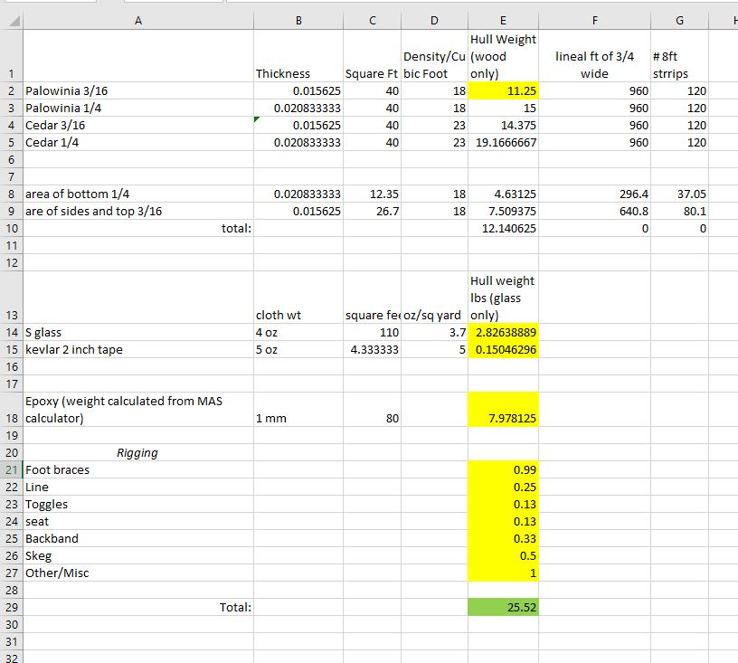

for all my builds the i am trying to build light,  i develop a bill of material with weights from the manufacturer as you cannot build a light boat of a certain weight unless you actually have a recipe that supports your approach.   i don't have one for a boat with okoume....but see the picture below for what i mean - the figures for okoume should be easy to get.....and you can experiment prior to building with your weight.

  3. fwiw, having a target and building that little bill of material spreadsheet with weights i found very useful for experimenting with trade-offs.   your boat, even at their design weight of 48 lbs are still lighter than most production boats....but if you can get into the 30 lbs zone you will find an amazing difference in terms of it just being easy to move around....which leads to more use.  the boat i have that gets the most use, fwiw, is my slightly below 30 lbs modfiied petrel play......
