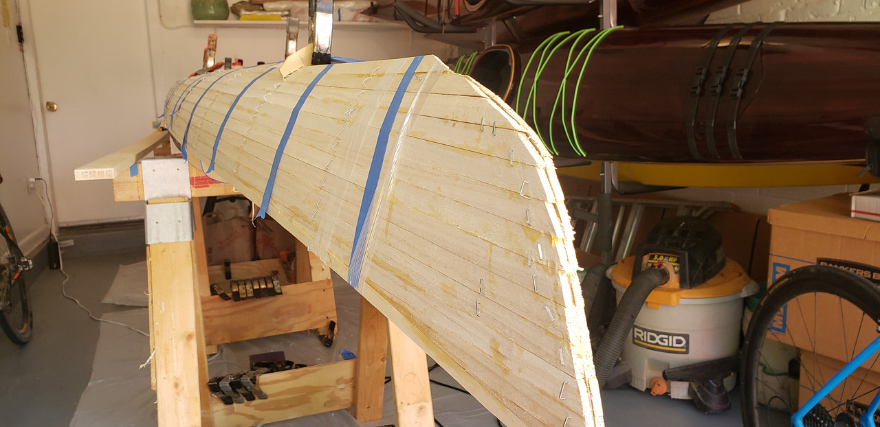

the picture below shows some of these techniques in operation.
you can see blue tape puling strips tight against the adjacent strip. at a point of a lot of twist, you can see the plywood clamped piece giving additional down tension on the strip forcing it against the form. once the glue sets, the blue tape and temporary clamps come off and the next strip is started.

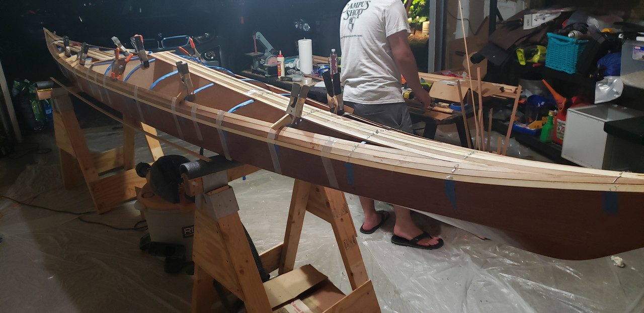

I thought i would add one more picture on a build more like your wood duck hybrid....
this is a night heron hybrid i built. in this picture you can see using strapping tape to pull the strip adjacent to the prior strip...and wood blocks with clamps being use to help bend the strip down to the frame....and then a staple.
in this build, there was more twist happening and i found strapping tape was necessary to generate the force i need to close gaps/move things around to where i wanted them. notice the wood/clamps are concentrated where there is twist (the face of the strip transitions from horizontal to vertical). it's those sections that tend to be the most challenging.
i also noticed in this picture that a lot of time i was angling the staple to drive one leg in deep with the other leg being left a bit open. this technique seemed to work on this boat and falls into the general category of setting up the angle of staple to best resist the pulling out force.
