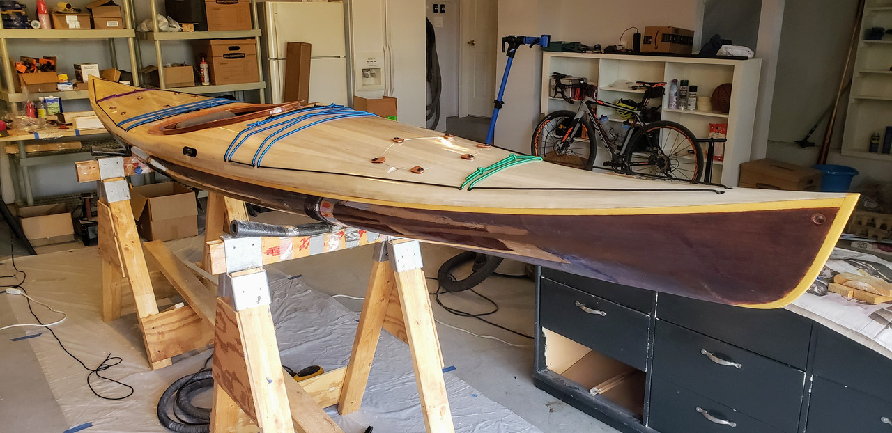

Hi Mike,
thought i would share a picture with you of one of my builds (hybrid night heron) with dynel strips on bow and stern (the black....and hard to see on the stern in this pic).
the skeg will almost certainly be inboard (ahead) of the stern rubstrip.   the skeg installation was complete prior to dynel rubstrip installation
   Hspira,
Thank you for posting the picture.  That is a beautiful boat!!  I like the look of the rub strip on the bow.
