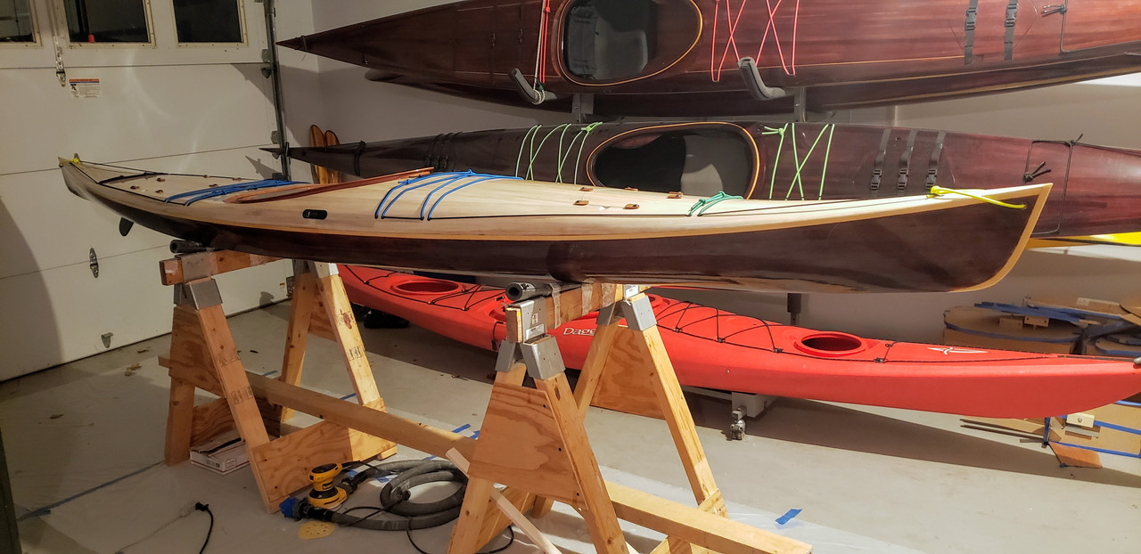

there are a couple different approaches to implementing.  i make my own skeg/housing (some in-progress pictures below) but use the control mechanism from superior kaykaks.
their website is https://www.nashboatworks.com/product-page/skeg-kit.  i like their product becuase their material is all fibreglass and the general design that they sell (and i build to when i make my own skeg/housing) is as bomb-proof an approach  i have ever seen.

 Mark, the pictures of your skeg are the exact one I plan on ordering. Did you make it flush on the bottom? Also, I noticed you seem to have it centered on the keel. Why there and not off center like the guillemot version?
