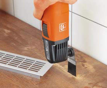

There was much hand-wringing, then the builder went and got one of these Fein Multimasters:
Using the thin wood-cutting blade, he cut the entire center seat assembly, daggerboard trunk and all, out of the boat.  The cut was so neat---right against the hull---that the assembly was simply rotated 180 degrees, new epoxy fillets were made, and the extra trunk opening in the bottom plugged.
