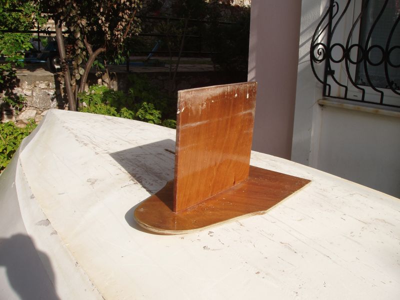

I enjoy rowing and built my Skerry primarily for that purpose, It's great exercise and the Skerry gets along very nicely. I rarely sail as I'm not much of a sailor although a neighbour often takes her out for a spin. To counteract the wet backside I made a dummy daggerboard with a top shaped to match the centre thwart. On top of that I have a pad made from a piece of camping sleeping mat cut to the shape of a Concept 2 rowing machine (I have one of those too for the winter workouts) seat pad. The photo shows the basic plug. Because I keep the boat in the sea for 5 or 6 months I treat the bottom couple of inches of the plug with anti foul the same as I do the bottom of the boat.
