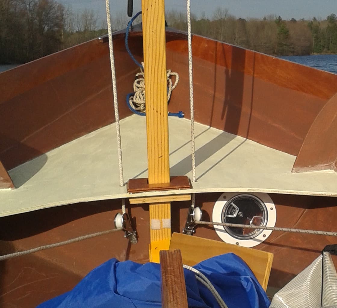

Here’s how I addressed the problem you describe. Main halyard is on starboard, boom pull-down line on port; those lines do crowd up the front compartment a bit, but since I’m usually solo, they’re not a problem.
