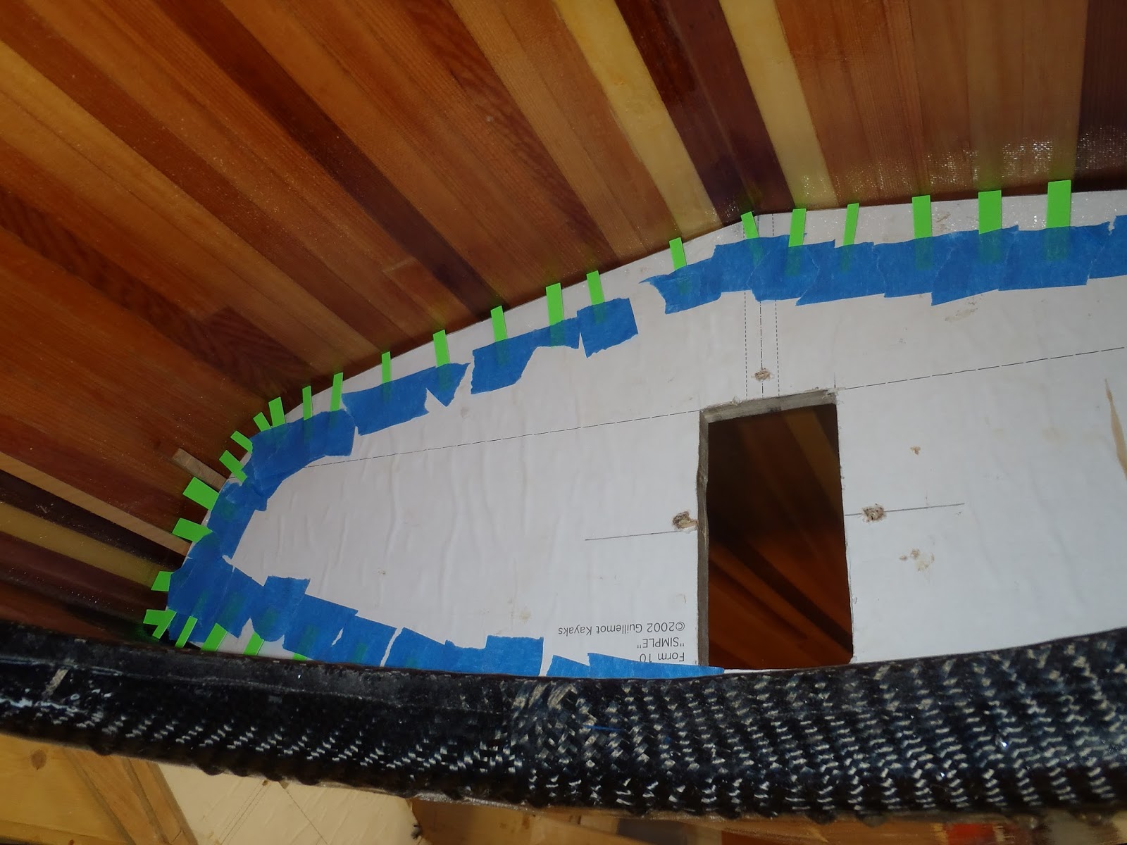

(Create a new bulkhead) Or you can use poster board to cut a new bulkhead template, transfer to a new bulkhead made from..plywood/fiberglass or whatever and glue to the old bulkhead to hide it totally. Now to do this you could do it several ways, but maybe you trace you current bulkhead to the poster board, and place(tape) the new poster board template up against the current bulkhead.  Then use some strips of poster board material (tabs) to outline the gaps.  Again, trace this to a new template and it should be on the money with no gaps/spaces.  Now this is similar on how I get tight fitting bulkheads building strip kayaks.  I use a station/form that closely matches where I want a bulkhead, and then use the posterboard tabs to outline the gaps.  Its tedious but works great.  Check out this pic. of bulkhead with outlined tabs.  http://2.bp.blogspot.com/-xuuuyZnAV7w/UJ2Wmx16JkI/AAAAAAAABXw/sWP4Mfg4xEs/s1600/P9290634.JPG
