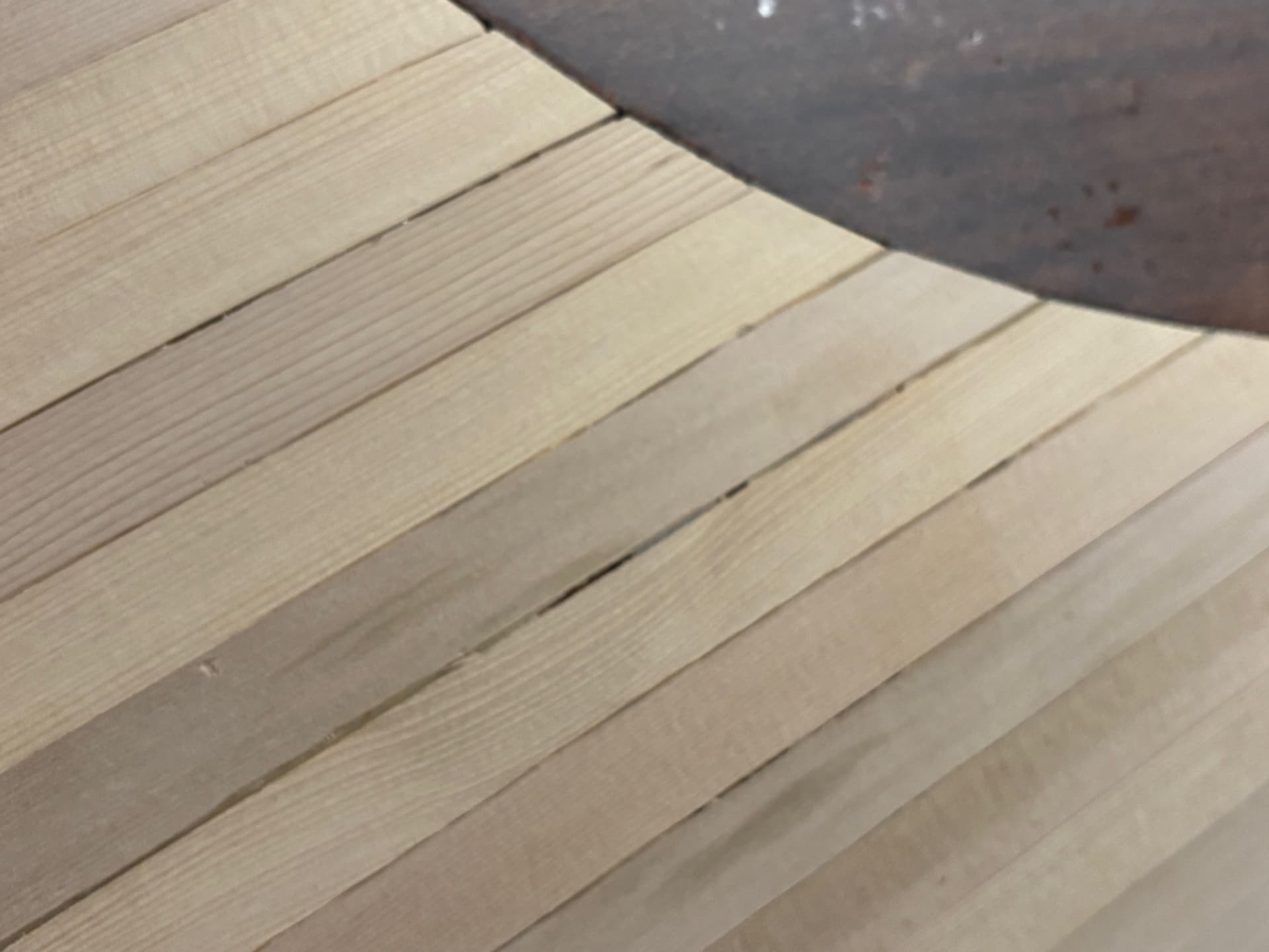

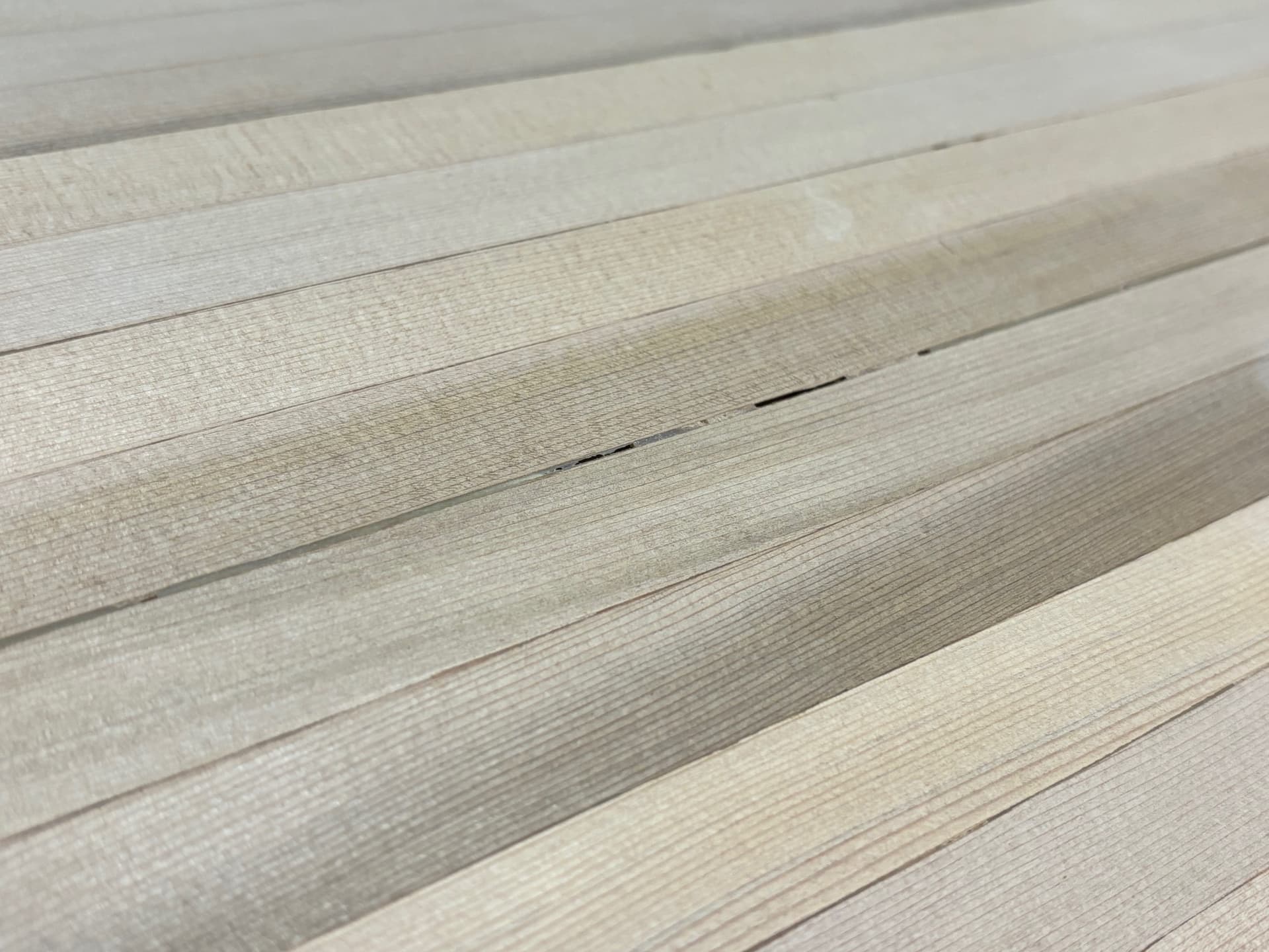

Yes Peter, gaps are 1/16 or less. See photos. My experience has been that these type of gaps will disappear between dark walnut strips with but with red or yellow cedar they become more noticeable when the epoxy and glass go on. I’ve used epoxy thickened with wood flour or dust from sanding to fill larger gaps and then have to sand them down. I tend to be a bit “annal” with my boatwork and was hoping that just leaving the wood dust in there would be a shortcut versus filling and sanding every little gap that I find.

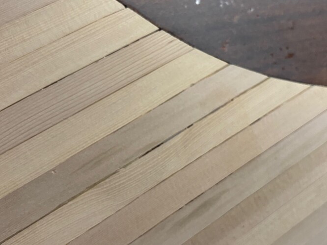

Hi Ron, here are two pictures that show the results of the technique i am describing. the first picture you can see lots of little gaps:
the second picture the gaps pretty much disappear. this technique is good for about a 16th of an inch gap or smaller.
i realize its hard to see…fwiw…i share your ‘anal’ perspective.

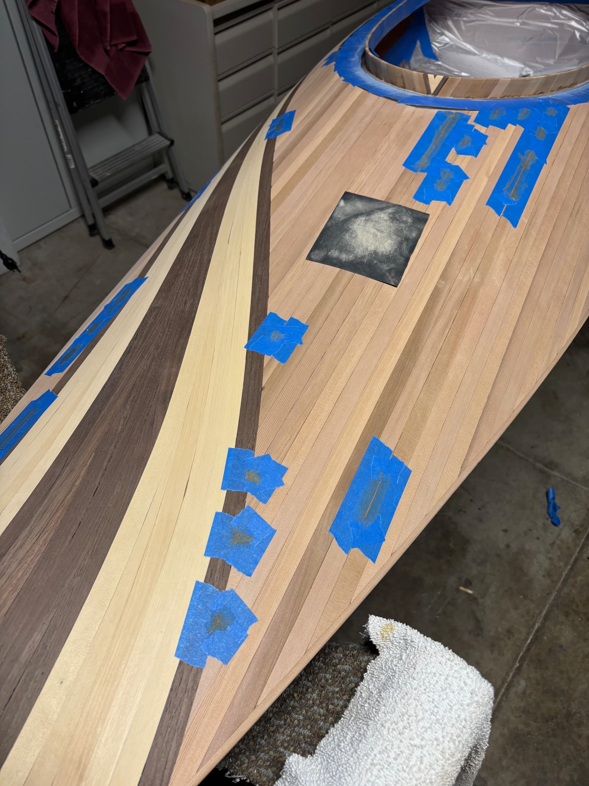

Spent a couple hours taping and filling gaps with a mix if yellow wood glue and sanddust. Another hour removing tape and sanding. Results are looking good. Of course with my neurosis, I see more gaps while I’ve been sanding these first gaps but so far I’m able to resist making another pass to try and fix every little spot.
