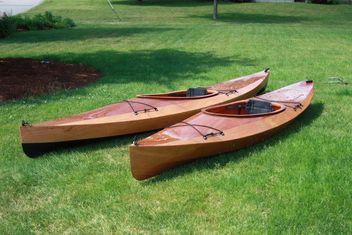

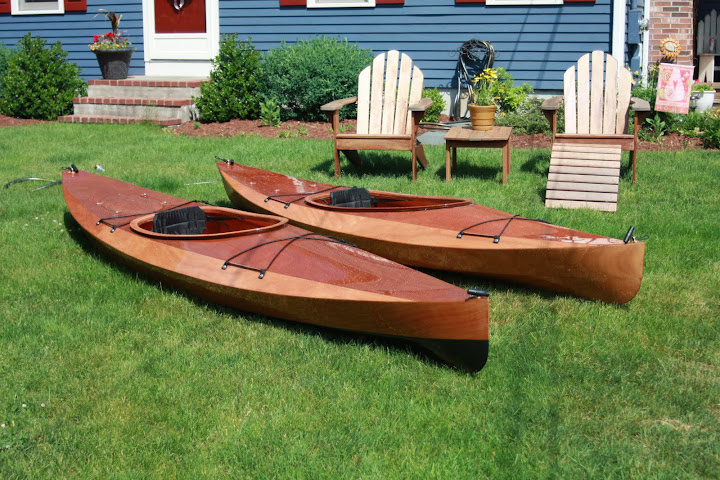

My WD10 has a new big brother, the WD12. Taking them both to the water this weekend. Very excited to have them both done and ready to use. A littel sad to be done building. Think I am going to have to go to the wooden boat show in June and check out the Wood Duck Double. That or a shearwater may be in the work for this winter

Beasutiful boats. I do dig the graphite bottoms.
Beautiful too.
Your bungees are attached to the boat with what?  Recessed "keepers" or are they right on top?  We are interested in the recessed keepers
Bungees use a fold of flat webbing with a bolt trim washer and locknut as shownn in the manual. nothing different, works well. I drilled, filled hole with epoxy and redrilled a smaller hole to keep the wood sealed.
