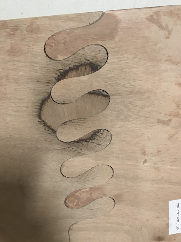

Thought i had burned the wood
So I'm just getting started with my PMD. I was using a new sander I wasn't quite used to yet, and discovered while sanding the puzzle joints after they had cured that I started to get what looked like burn marks. Well the secret to burn marks is to let it cool and then sand them out on a slower setting. Well, after I while I discoverd the obvious.....these weren't burn marks, but the next darker layer of the Okoume. :( :( :(
Any ideas of what I should do? Do I just leave it as is and continue on? Coat it again with epoxy and just make sure that I don't sand as far as I did the first time?
https://postimg.cc/jnNW74t6
Definitely coat them with epoxy and forget about a varnish finish on that part of the boat. Paint is your friend, it covers a multitude of sins.
It looks from that image that the joint was not flat since the fingers on one piece of wood are sanded entirely through the first layer and pretty deep into the second while the other piece looks normal. i suspect that the back side of the joint is just as bumpy, right? Because of that there may be some structural issues to fix as well. Fortunately, it's easy.
On the back side, get rid of the bumps by either sanding it the way you did the front or filling the low spots with epoxy/woodflour and then smoothing it. Then put a piece of fiberglass over both sides of the joint, front and back. It should be relatively heavy cloth. I'd use either a single 6 oz piece or two 4 oz pieces on top of each other.  The glass should be as wide as the joint plus 2 inches on each side of the fingers. Do that on each side. If you use 2 layers of 4 oz, make the bottom layer 3 inches on each side of the fingers. Thay will let you smooth the patch more easily. WIth one heavy layer you're going to have to feather the edges.
The glass patches will more than restore the strength you lost by grinding away the veneers. Done carefully and with good surface prep for paint it will be completely invisible under the paint.
Good luck,

   I did the same thing on the puzzle joint in the rear on the side panel on my Shearwater 17 build.  CLC sells some wooden inlays/onlays.  I am thinking of getting one that will have my boat name and the year I built the boat to cover it.  Your area looks larger and I am not sure where it is, but I want to throw out the idea as an option.
