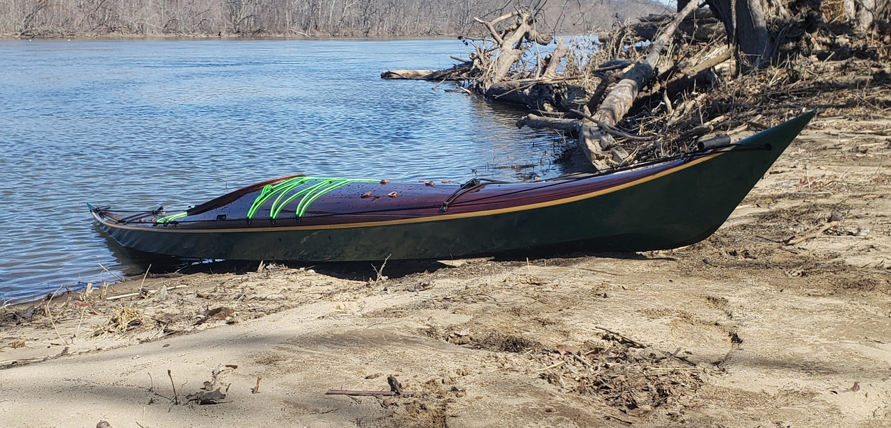

this is a picture of my shearwater - these are very nice boats:

h, your shearwater looks very nice.  Do you have a higher resolution picture to show the deck riggings and perimeter lines?   I just want to get the idea where to drill the screw holes on the deck  and how  to use the toggle holes for adding the perimeter lines

if you right click on the picture you can try 'open in new tab' and should be able to enlarge it.
i can see the perimeter line and locations pretty well.  is there a particular detail you are looking for?  the boat is built pretty stock (per plans).  but if there is an area of detail, i might have a different picture i can find.
i am very curious about your project to build a sectional shearwater 17.   can you share a bit more about the project?.  for perimeter lines, you will need to line stuff up along the cuts to make it convenient....so there will likely be some customizing of the rigging plan in order to accomodate the sections.
