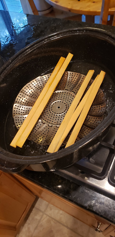

Steam will make a big difference.  When I was building I used a big turkey pot (big pan and cover) and then I put grate in it to keep the wood out of the water and then just boiled/steamed it for quite a while.

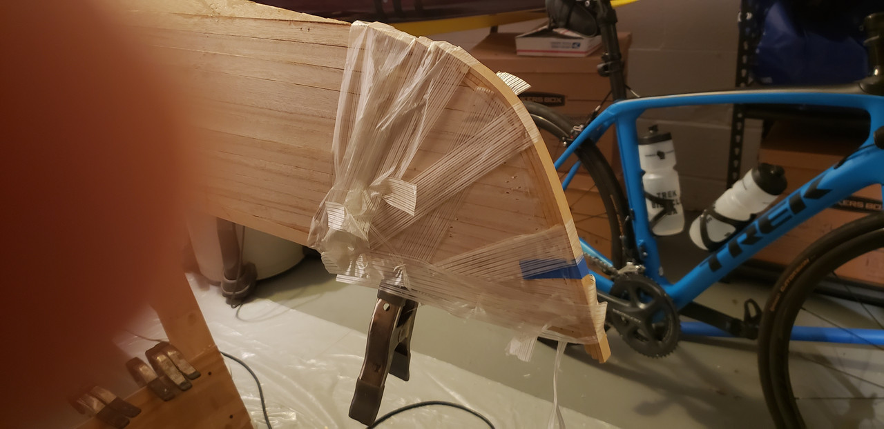

I then temporarily pulled the piece into position onto the form with clampse as it dried/cooled….then I did my final glue with wood glue with strapping tape….and it came out just fine.
Below are three pictures.  The first picture is the wood in the turkey pot (most of the time it was in there with the top on.  the second picture is the pulling the freshly steamed wood into position on the form….and then the final picture is actually gluing it up with wood glue.
Not the same boat….but the same idea.  It did take a while of steaming….at some point, kind of like brisket, it finally yielded.  Btw…I needed pot holders to handle the hot wood.   i also agree you should cut the pieces into 1 inch strips

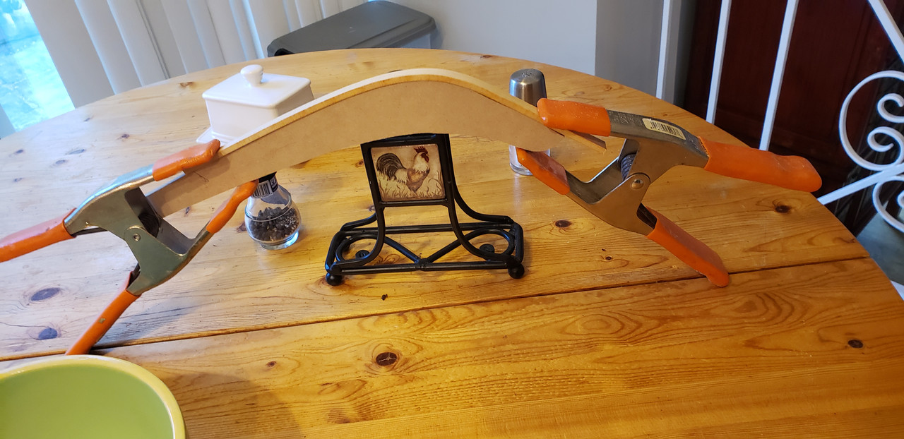

My approach is a little different.  I soak the strips in a bucket of water for an hour then use a heat gun to bend the wet strips in place.  Since I use tape, I can only do one or two strips at a time but with the clamp holes in your forms, you may be able to do more.  Once the strips have dried, they will retain the shape so easy enough to remove and then glue in place.
You probably know this, but do not glue the first strip of the inner stem to your form.
