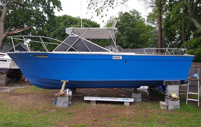

A while ago I did some due diligence by trying to find real world examples of the Interlux blues actually painted on something. So while the largo blue paint card initially attracted me as 'pretty close', when I saw pics of them on boats I was surprised by how far off the colors were from what I am looking for.
For example, here are a couple of photos of boats stating they used Interlux Brightside Largo Blue:
Maybe its the high gloss or the lighting, maybe its just me  but these boats above do not look like the Largo Blue paint card to me at all.
And here's one of Interlux Brightside Medium Blue, closer to the paint card imo but still not it:
All of this is to say I am totally lost here as to how or why the paint cards seem so different to my eyes. Am I alone here? Is it just a matter of a flatter color?
