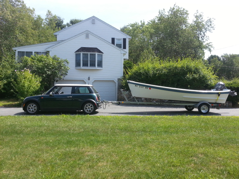

"Minimum vehicle" can mean different things to different people.  Auto and truck manufacturers state the towing capacity of their products (in pounds in the U.S.).  For example, my 2003 MINI Cooper is rated at 1500 pounds which is twice what I need for my Peeler Skiff and trailer.  The car has a manual transmission and excellent 4-wheel disk brakes.  I believe that you need to look at the following factors:
  1. Rated towing capacity - leave a safe margin especially if you need to operate in hilly or mountainous terrain
  2. Brakes - emergency stopping is very important and drum brakes don't work well when wet
  3. Visibility - you'll need a wide enough vehicle to be able to use (and/or mount) side mirrors that are able to see around the boat
  4. Axle height and ground clearance - you need to be able to back down a ramp far enough to launch and retrieve the boat and saltwater is tough on wheel bearings
I hope this helps a little.
Cheers!
