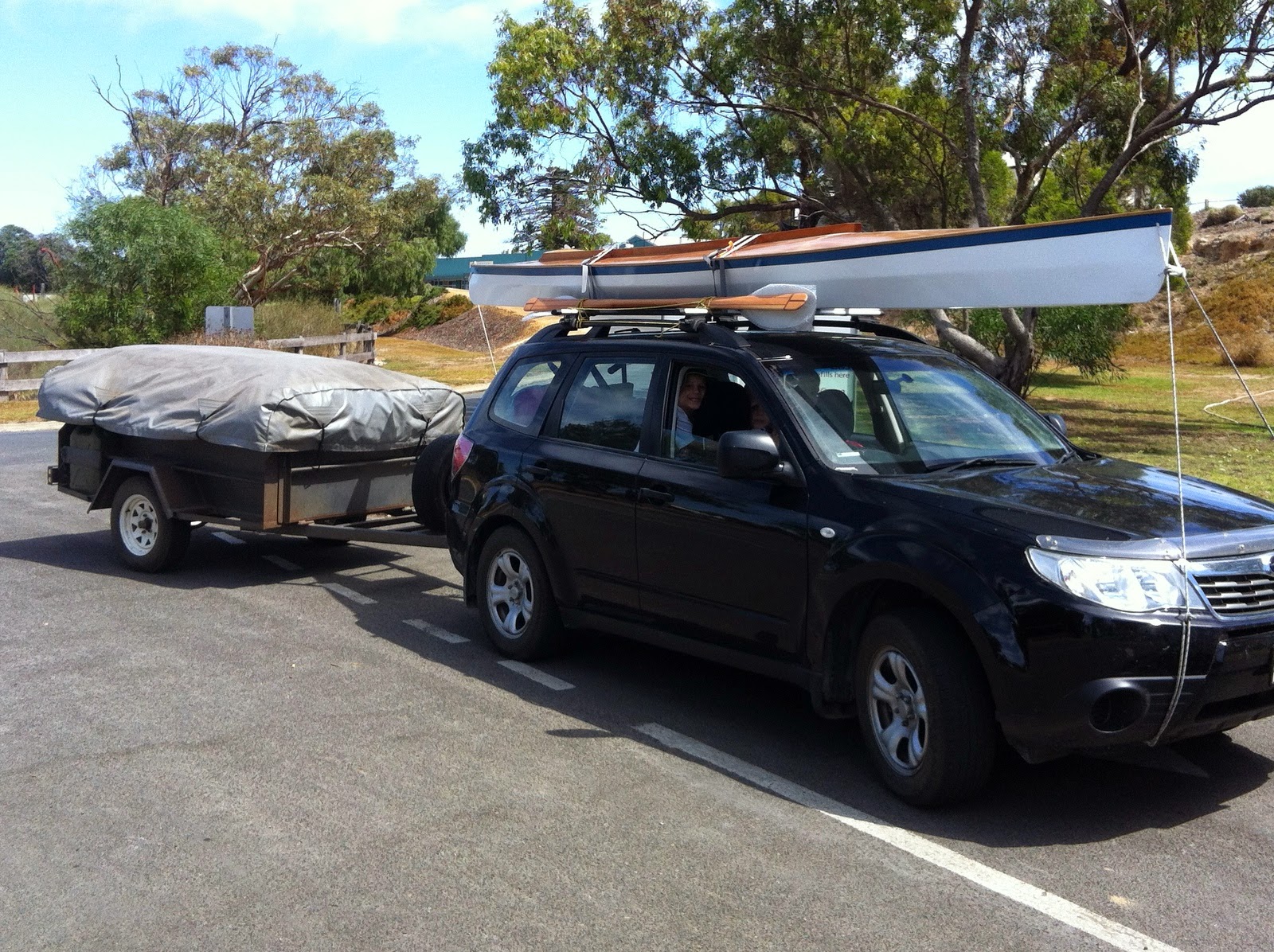

I've transported my Mill Creek 16.5 on the factory thule roof racks that came with my Forester. I would have liked the bars to be spaced a bit further apart, but they have held the kayak well (right side up). I used straps over the coamings, and whilst I too was concerned at the pressure on them, it has been fine. I tied the front and rear down, and it never moved an inch on a 200km highway drive (I stayed under 95km/h though).
I'm still need to sort out a loading mechanism so I can load/unload myself though.
I've got some photos on my build blog at: http://millcreekkayakbuild.blogspot.com.au/
Cheers,
Justin.
