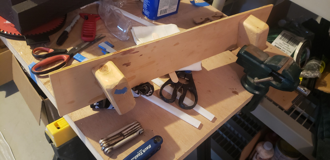

   I made my own longboard for the SUP because of larger flatter surfaces.  I cut out a piece of thin plywood, but should have used thinner because it needed more give and glued on a couple of handles from scrap wood.  But I got a couple of plain belt sander belts, the longest I could and cut them and used spray adhesive to stick them to the board.  I think they're 120 grit. Vacuum them out (if you are dry sanding) often to make them last longer.   On the skerry I just used my foam blocks and sticks or dowels for tight places with paper wrapped around them.  I did use the orbital sander on the bottom and seats, attached to the shop vac w/ HEPA filter but on the hull planks, there's just too many corners and curves for me to use the power tools.
apologies.. still can't see any evidence of a picture above (using Chrome browser and MS Edge on windows 11 computer).  but can see them on an iphone using safari.   strange...have never had quite that problem before.
just wanted to add that i have made a longboard before for faring and it worked great.  i made a strip of 3/16 ply x 3 inches X 22 inches and used an inexpensive spray adhesive and glued two pieces of 80 grit sanpaper to it (11 inch length X 2).
emphasis on the word 'faring' for making fare surface (no broad divits or bulges) so i think of faring as an agressive but controlled form of cutting.  then i  followed it up by hand with 120, 180, 220 etc to take the scratches out.  basically it sounds like i did what mumichog did....quick pictures below...bit of a mess in the shop so did not take any time to stage these pictures or clean up :)
