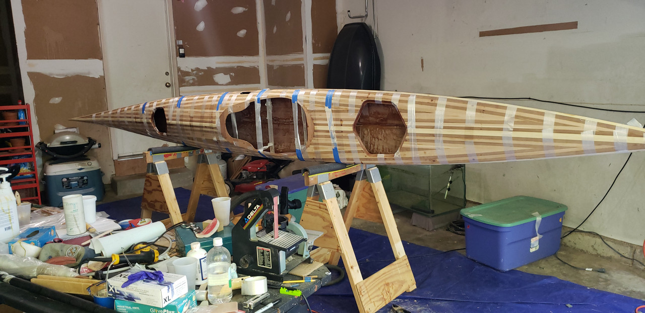

hi air dog,
just read your description again....and do want to suggest, that after you get hull/deck seperated, that you reach out again on how the hull and deck get joined.
the process for joining the hull and deck of the shearwater should be very low drama as everything should be held togther tempoarily with strapping tape.....giving you plenty of opportunity to check/confirm alignment before any epoxy comes into play.
while not a shearwater, here is a picture of what i mean by strapping tape to temporarily attach the deck to the hull:
and here is a picture of my shearwater:
