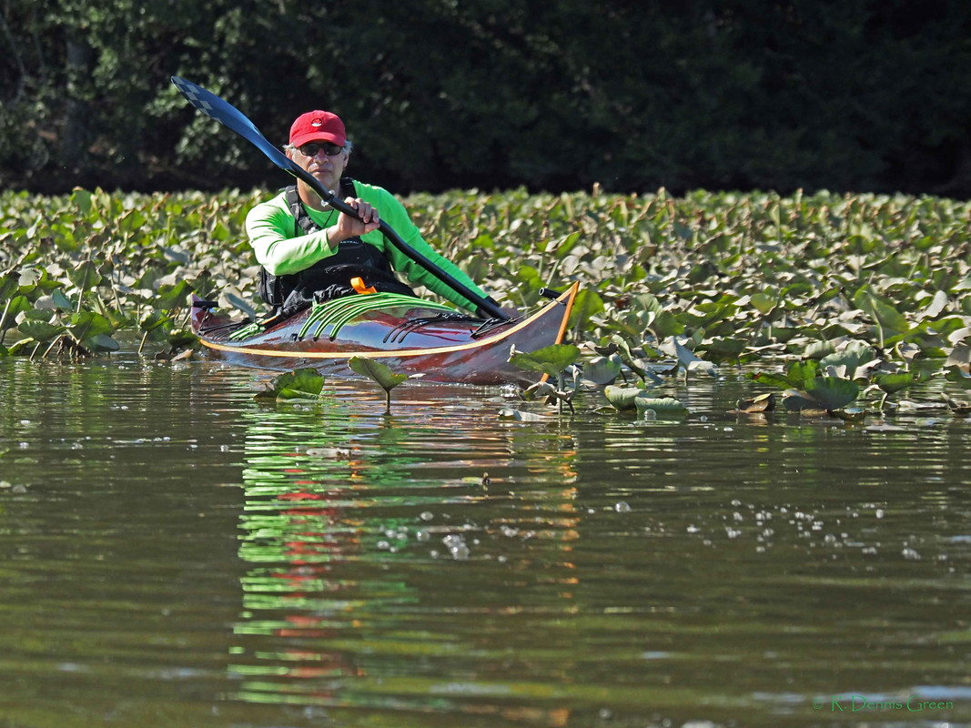

picture below is a recently refinished 10 year old night heron with 5 coats of varnsih..  apologies for not smiling...i was really very happy inside.
