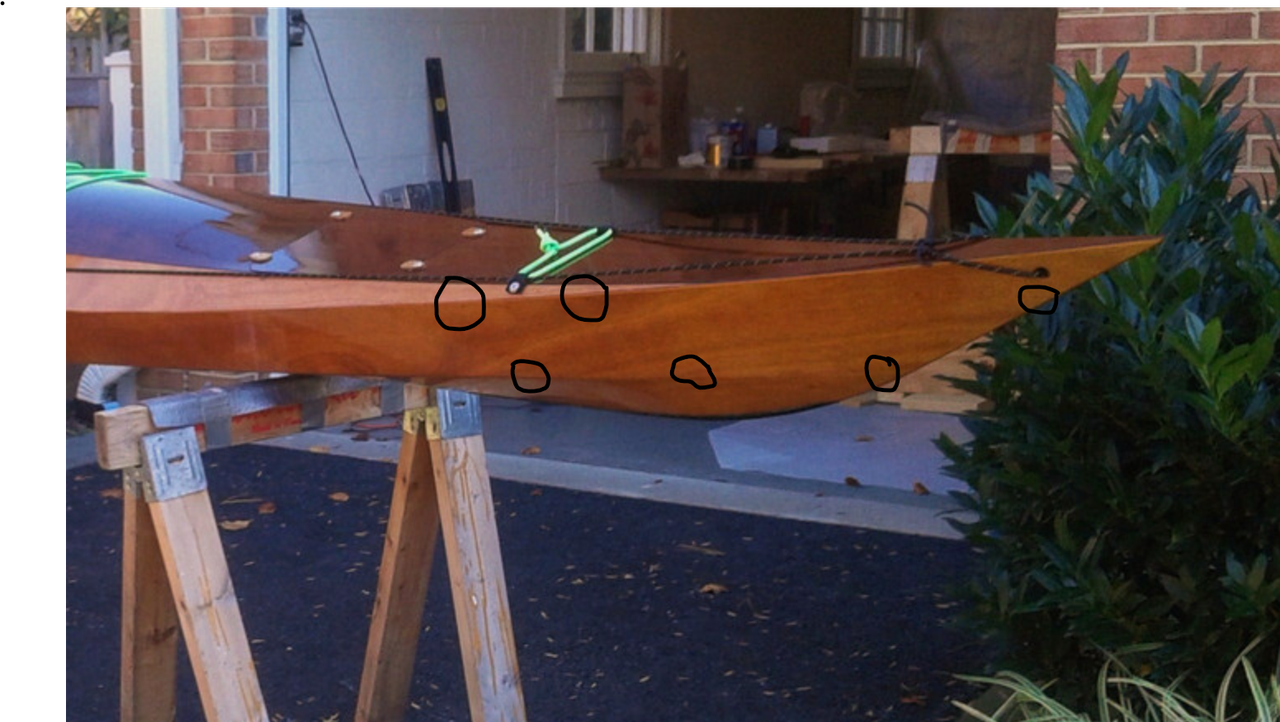

for me the answer is 'from what perspective'.....and "how does the eye work".   so my short answer is, as a practical matter, nobody see stitch and glues holes....they 'disappear' unless you go looking for them.   and with respect to laszlo, i have never seen them look like 'rivets' from a normal view/perspective.  to see them, you have to be up close and looking for them.
the picture below is fairly high resolution, brite sheawater i built.   i did nothing to hide the wire holes (i did generally try to be careful and make them no larger than required).
as you can see, from a couple steps away, you basically do not see them.  now if you come up really close and look really hard.....you might be able to see some   you can try enlarging the photo posted here (open it up on a seperate tab and enlarge) and see what you see....but you will probably not see them even then.
now if i tell you where they are, you may now 'see them'  which is in the pic below.....so consider looking on an enlarged photo before scrolling down.
so here is the enlarged photo with some of the wire holes circled:
so as a practical matter, i would just let them fill with epoxy......there are a lot of other things that are more going to 'catch' the eye on a brite build then these little holes.
from a 'how the eye works'....your eye will be drawn to the seam.....and away from these surrounding little dots ....they are just not close enough to one another typically for the eye to start to recognize them.

   Thank you all for responding!  From the picture Hspira posted, the stitch holes could look like darker spots in the wood, such as knots, to the untrained eye.  I am not going to try and match the color to fill them.  They are merely artifacts of the construction method as Laszlo pointed out.
