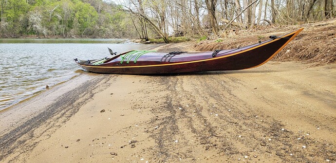

fwiw, i have experience on option 2 in the boat in the picture below. on its maiden voyage i accidentally paddled it over a piece of rebar sticking out of concrete blocks along the shoreline where i was paddling…. putting a five foot scratch through the epoxy and deep into the glass……as if somebody dragged a knife down the bottom of the boat. the five sessions got done in about an elapsed week of time…and then nobody knew anything had ever happened.
if it were me, i would probably do option 2 . but you can also go option 1 if you want to kayak sooner rather than later and do option 2 during the off season if you have one. in that case, i would avoid the varnish step …until i completed option 2.
