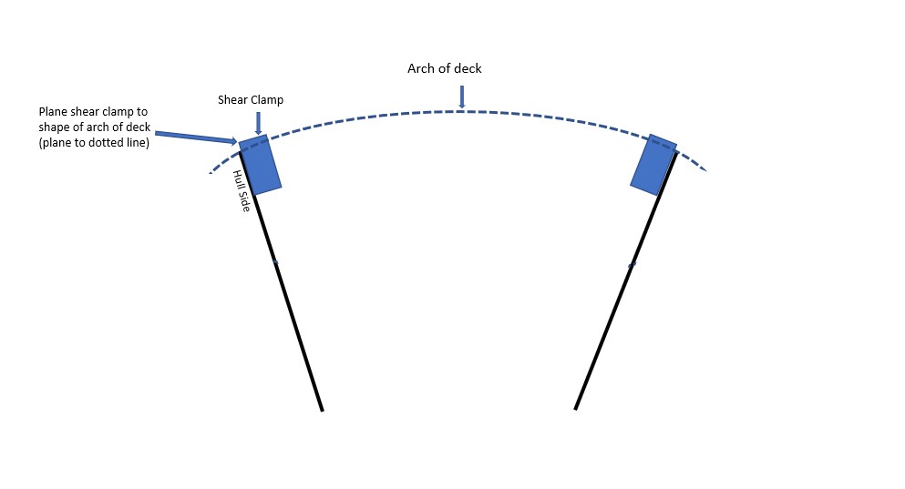

hi sdillard,
apologies but i looked at your pictures and now i am confused. the shear clamps are in the inside of the hull.....your picture seems to suggest they are on the outside?
anyway, i have made the following picture which i hope is clear about what i think you need to be doing:
so the temporary forms (upon which you will build the strip deck) is the 'arch of the deck' in this picture. the shear clamps are the blue blocks glued to the inside sides of the hull which are the thick black lines. so you plane the shear clamp per the arch of the deck which changes depending on where you are (hence the rolling bevel). the back of the deck will be relatively flat (not a lot of arch) and it will be more arched in the front section of the kayak.
i hope this makes it really clear.
