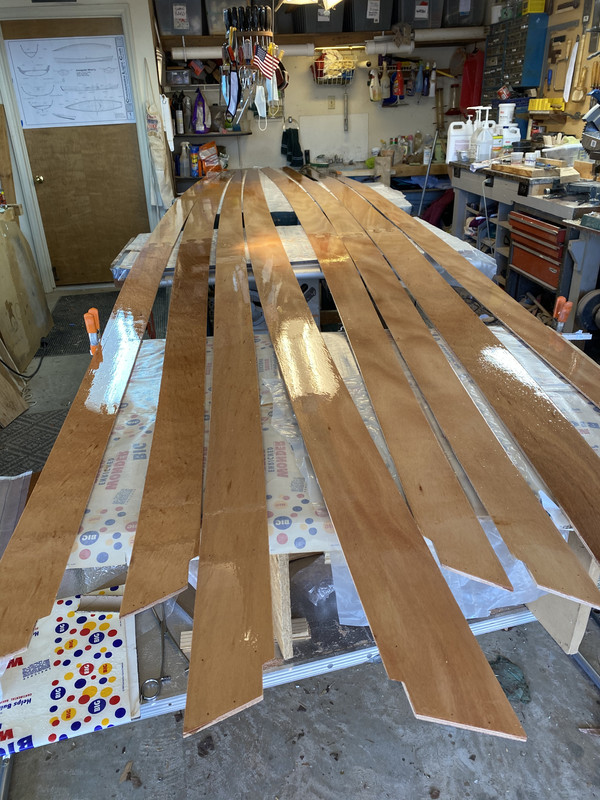

I glued up the puzzle joints, and pre-coated all panels with 2coats of epoxy, except for the exterior #1's.  Also, I pre-glassed the interior of the #1&2's.  They all get sanded with 220 grit paper.  This is so easy to do on the flat with an ROS.  Next step is to (finally) stitch the panels together.

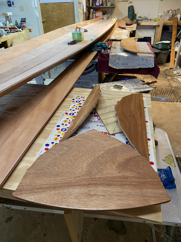

   Today, in addition to my workout, cleaning the basement, and the total breakdown of our furnace, I did manage to liberate the lower panels from the surrounding fiberglass.

   Yeah, sorry about that. Glassing the inside of the panels on a flat surface has definite advantages. I was concerned that it would make the panels too stiff to wire together but I did some test pieces with scrap plywood first and bent and twisted them and it was not an issue.
Doing a mockup is always a smart thing.  I did that before committing to this alternate process.

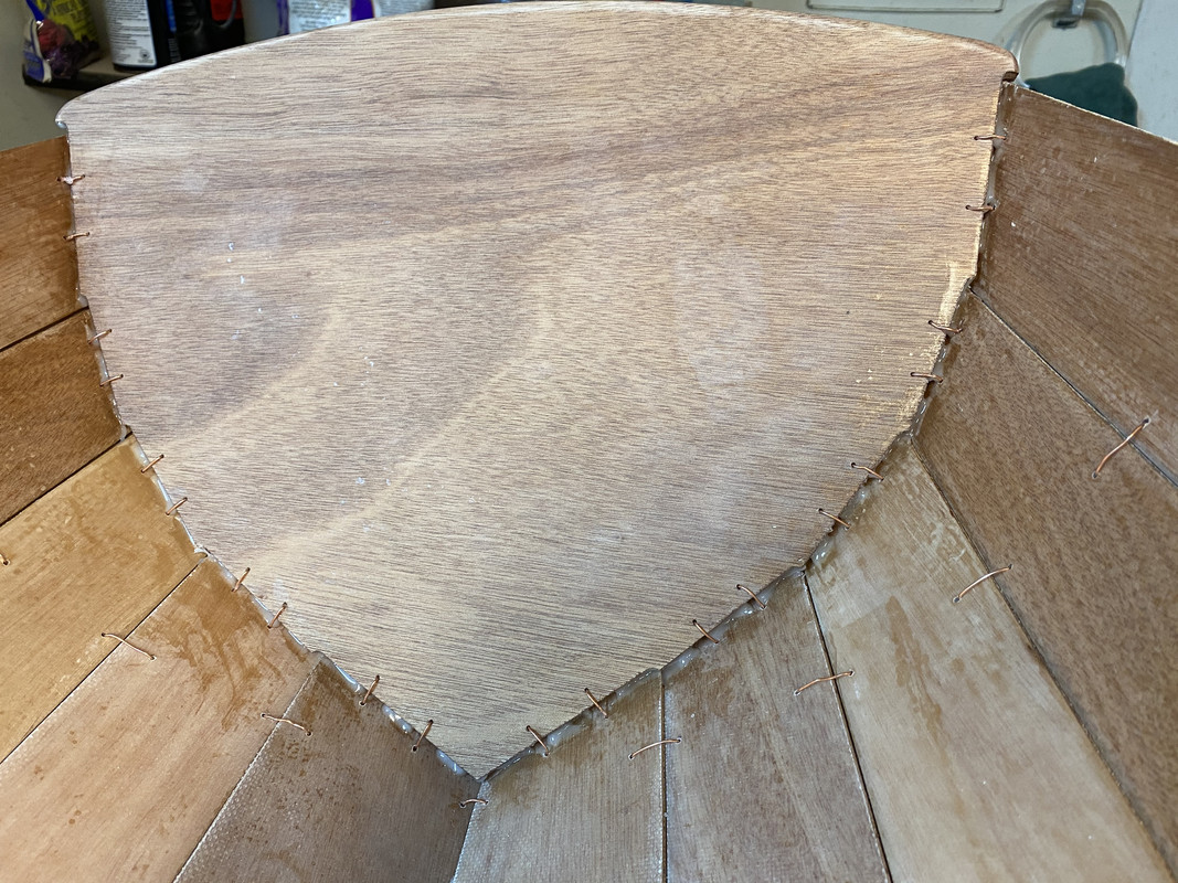

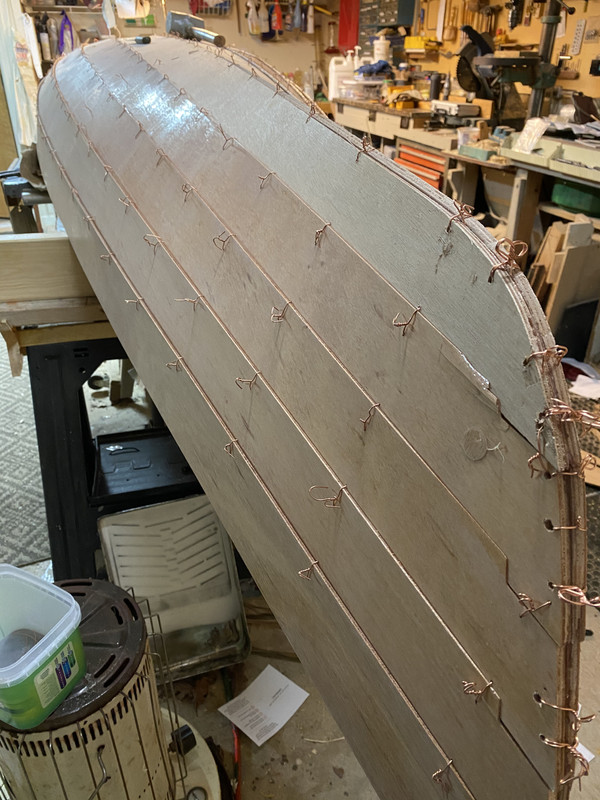

I am now into the conventional stitching steps of this build.  I'll only post occasionally, until I get to the unique parts of the process.  But here is my status, as of this morning.    Panels 1-3 have been stitched together.  I'm pre-coating the bulkheads and transom now.  Once they have two coats, and are sanded, they will be wired in.
   I've gotten everything stitched together now.  I'm tightenjng the stitches, and preparing to glue up the stem and transom.
   Today, I am tack gluing the transom.  That will allow me to remove the wires, before I fillet the transom in.  I don't want any copper showing on the varnished transom.

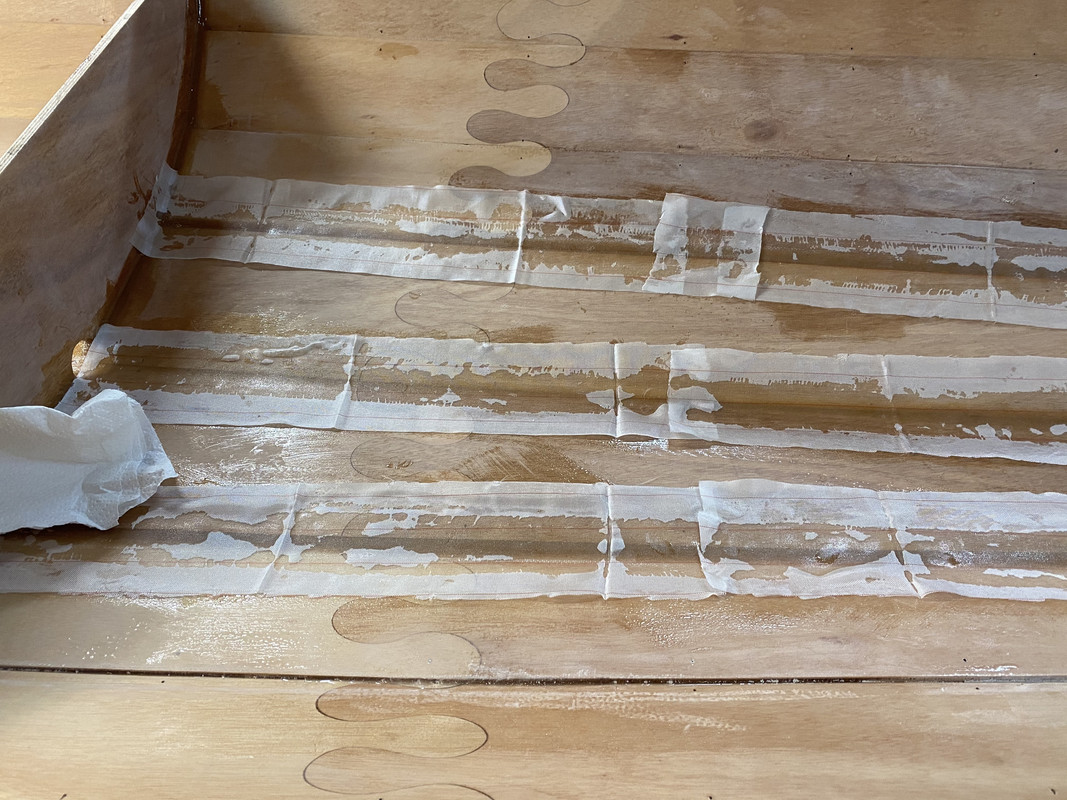

Now, the boat is ready for interior glassing.  But since I've already clad the panels in cloth, they only need to be welded together.  I will use the method outlined in Russel Brown's book "Epoxy Basics" mentioned above.

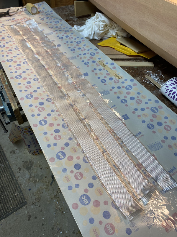

I've cut strips of cloth off the roll of glass provided with the kit.  Then, I peeled away a few strands to give me a fringe all around.  Note: you can't use traditional glass tape for this, because it contains a thicker thread on each selvage.  Then, I saturated the strips with epoxy.Then, I placed the strips on the seams, and placed strips of Peel Ply over them.  I patted it down, sonthe epoxy could soak into the Peel Ply.

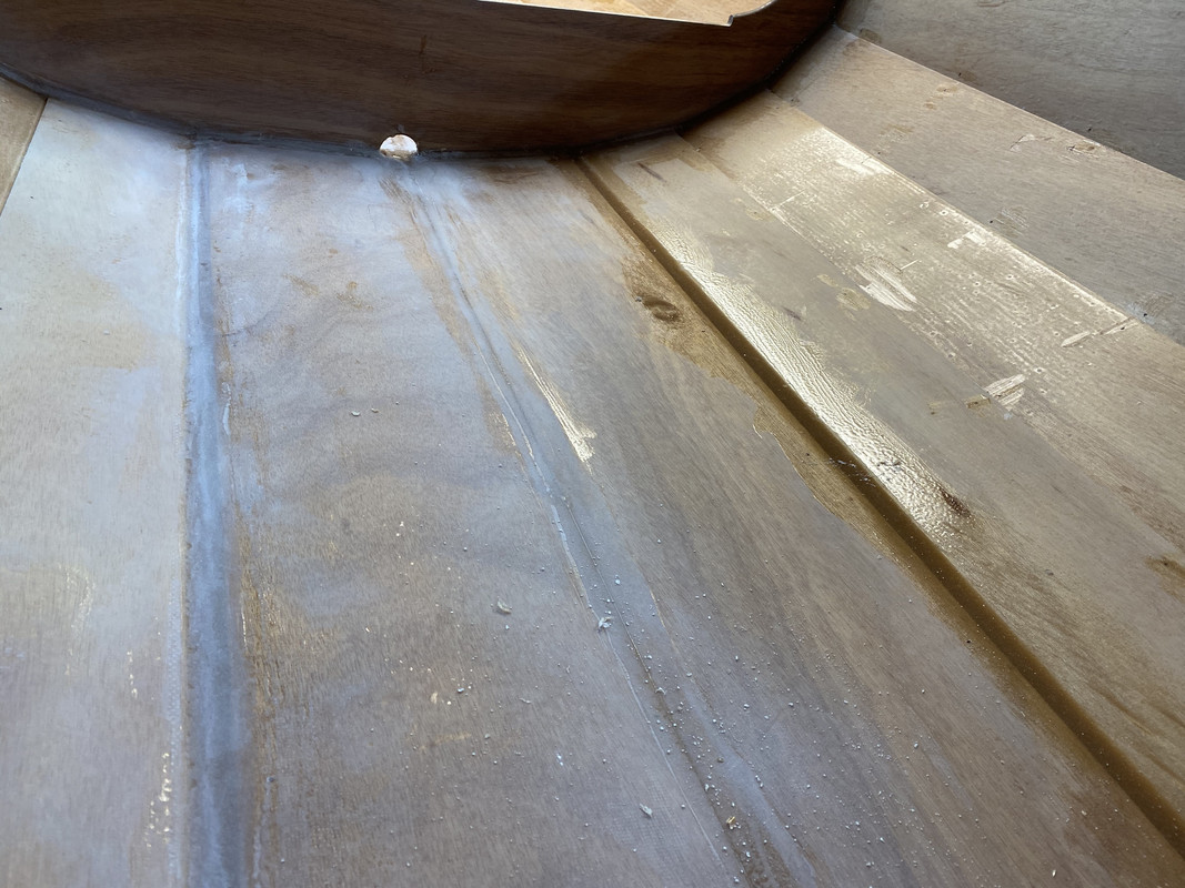

The results were astounding!  When I peeled the Peel Ply away, I was left with a sloghtly textured surface, which is easily sanded.  I did learn that I needed to iron the fold wrinkles out of my Peel Ply.
For a point of comparison, I did not use Peel Ply aft of bulkhead #4.  This area is sealed up, and not visible.

I only used this method on the interior. It is not necessary on the exterior, a d Won't work.   It was my first time.  I bought one package of 60"x 2 yd  WEST release fabric, and it was plenty.  But plan it out, and do the math.  Figure on 4" wide strips (that is generous) 2' long with a 1/2" overlap.  Per Russel Brown, Peel Ply doesn't make corners well, so you make short overlapping runs.
Do know that this method has it's own areas of tedium. One being the cutting of the tapes.  DO NOT use roll tape with this method.  And buy the book and/or watch the videos.
Some use Peel Ply for the entire exterior panels.  I've seen this, and it works great.  But it does not do compound curves.

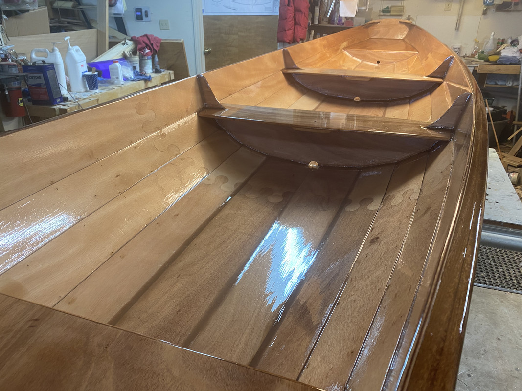

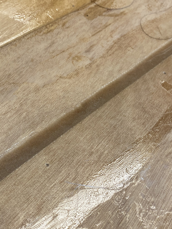

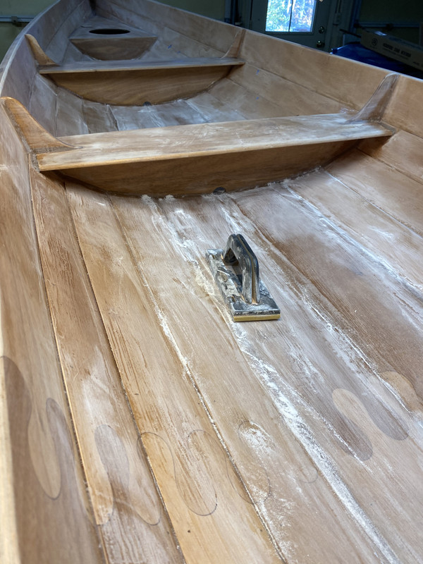

   The Russel Brown technique wasn’t quite as successful as I had hoped for.  There were high spots along the edges.  They were easier to sand out than a ridge of glass tape would have been.  There was still more sanding than I was expecting.  Would I do this again?  Yes, probably, to see if I couldn’t do a better job.
Hi Thrillsbe,
looks fantastic.  can you let us know about the order of the pictures.  is the first one that looks really clean varnish or a final coat of epoxy?  are the sanding ones effort that took place before that first picture....or just more sanding.
