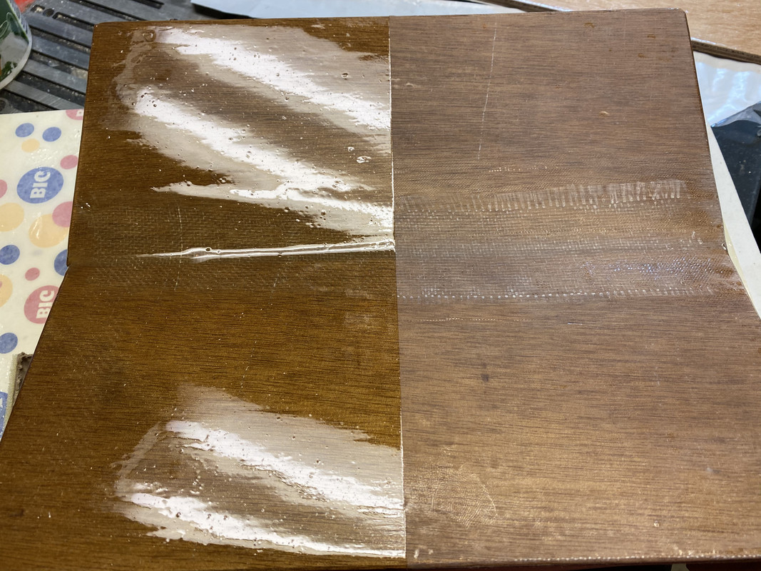

   So, I did my mockup, and it went well.  Here's what I did.
  1. I applied 6 oz glass cloth to two panels with a light coat of epoxy
  2. I gave them a second coat of epoxy while the first coat was firm but still green.
  3. I sanded them with 220, and joined them with a fillet.
  4. I sanded the fillet smooth, once cured.
  5. I cut a piece of tape out of some 6 oz cloth, saturated it with epoxy, and laid it onto the fillet.
  6. I placed Peel Ply over the joint.
  7. When cured, I removed the Peel Ply.  The joint only required light sanding before varnishing.  The tape blended into the panels!
   Here's a photo showing the end result.  The right side is after the Peel Ply has been removed, and the piece lightly sanded with 220.  The left is after three coats of Flagship and one coat of Captains varnish.
