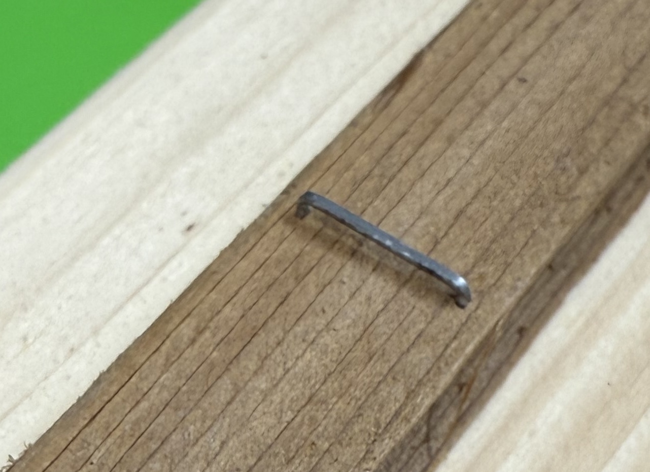

I have used a couple of different solutions. Sometimes I tape a thin (1/8”) strip of wood to the bottom of the stapler. Other times, I drive each staple through a small square of heavy duty cardboard (not corrugated).
When building my Petrel Play I bought a Stanley Fat Max stapler from our local DIY store. This is in the UK, not sure if you can find these in the US though. This has an adjustment which controls the amount of force the stapler uses. When set to the minimum the staples were left proud of the wood allowing quick and easy extraction, and I didn’t have any breakages either. I used Stanley TRA206T1 type A. 3/53/530. 10 mm staples.
