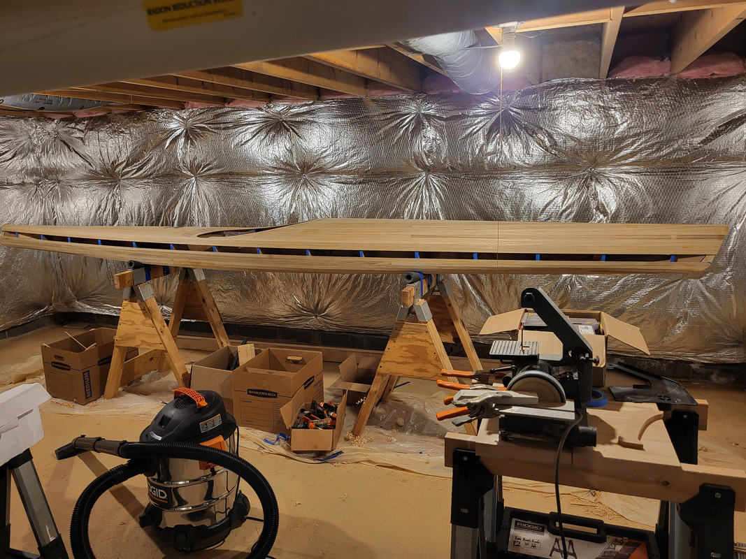

I am currently working in an unfinished part of my basement and all my sanding and cutting tools have vacuum hose attachments which I am finding very effective.
However, when I get to varnish work and sanding epoxy where there are more fumes and fine dust involved, I will move the project to a garage bay where I can work with an open door to the outside.
below is current kayak project in unfinished part of my basement.
