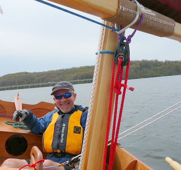

Yeah, a leather cuff around the mast at the partner works well. This is a pic of my PMD lug rig mast step. You might also consider sowing leather around the spars where they intersect with the mast. It makes as much sense as sowing leather onto your oars. For more... C-Lute Blog

Great pictures, thanks!
And that is an excellent blog.  I will read it in detail and copy notes out of it...very helpful on may ideas.
For example...I like your sewn leathers.  I bought the nail-on leathers from CLC for the Dory I'm building but I prefer the looks of sewn on. Did you already know how to do that or did you learn on this boat?
Also, now that you are using the boat, would you do the leather on the mast step and mast partner the same way?  I was wondering if perhaps contact cement would work to hold the leather and thus no nails?

Thank you, Curt. This was my first effort in sewing. Video clips on youTube helped. Once I put my mind on it, it was not really too bad and actually sort of fun. I would definitely do it that same way again. Check out this blog entry which specifically deals with the leather.
I did it the same way for the spars and the mast cuff. I also nailed some leather directly on the foot to absorb any chafing. This I might not do again in the same way since it occasionally hangs up when I lift out (unstep) the mast. It's a very minor thing and it does have the desired effect, so I have not removed it either.
I don't think that contact cement would be a good choice...  you might want to check with someone at CLC about that though.
