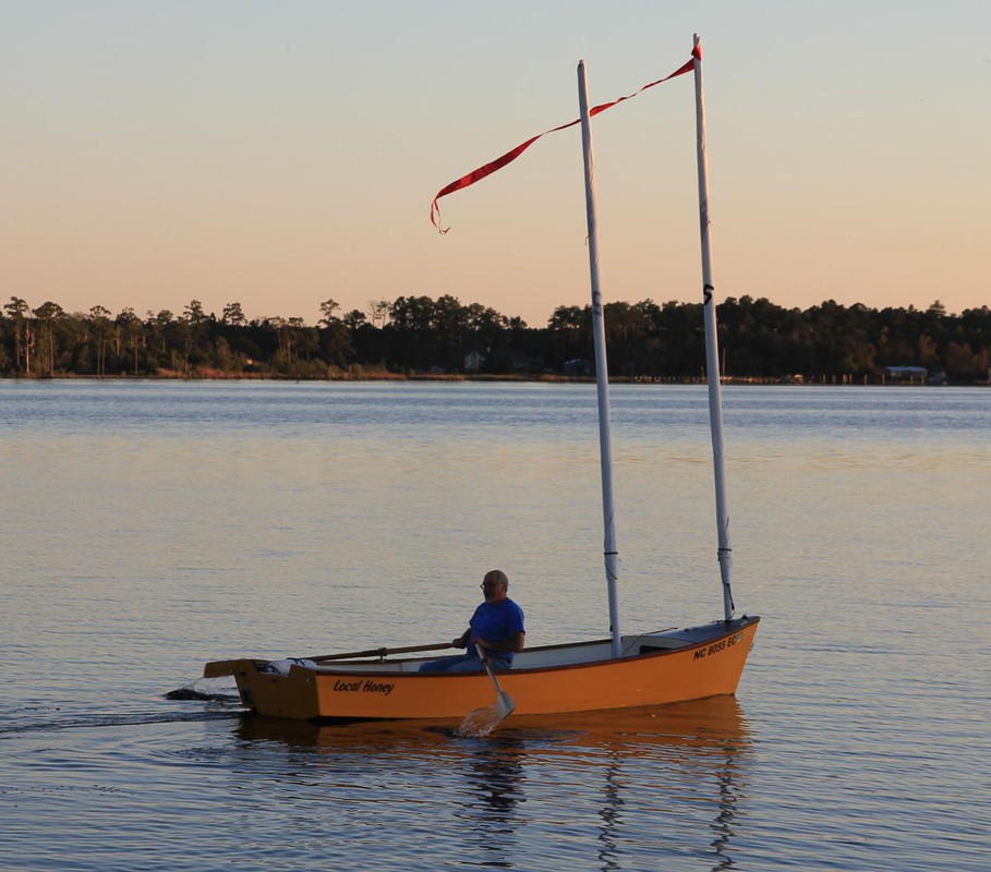

Is there any reason you cannot step the mast before rowing? A gridge, perhaps? If not, step the mast at the dock, and furl your sail on the mast. This is how I do it
on my cat ketch. (The mizzen has been moved forward to a secondary position.
I meant "bridge".
