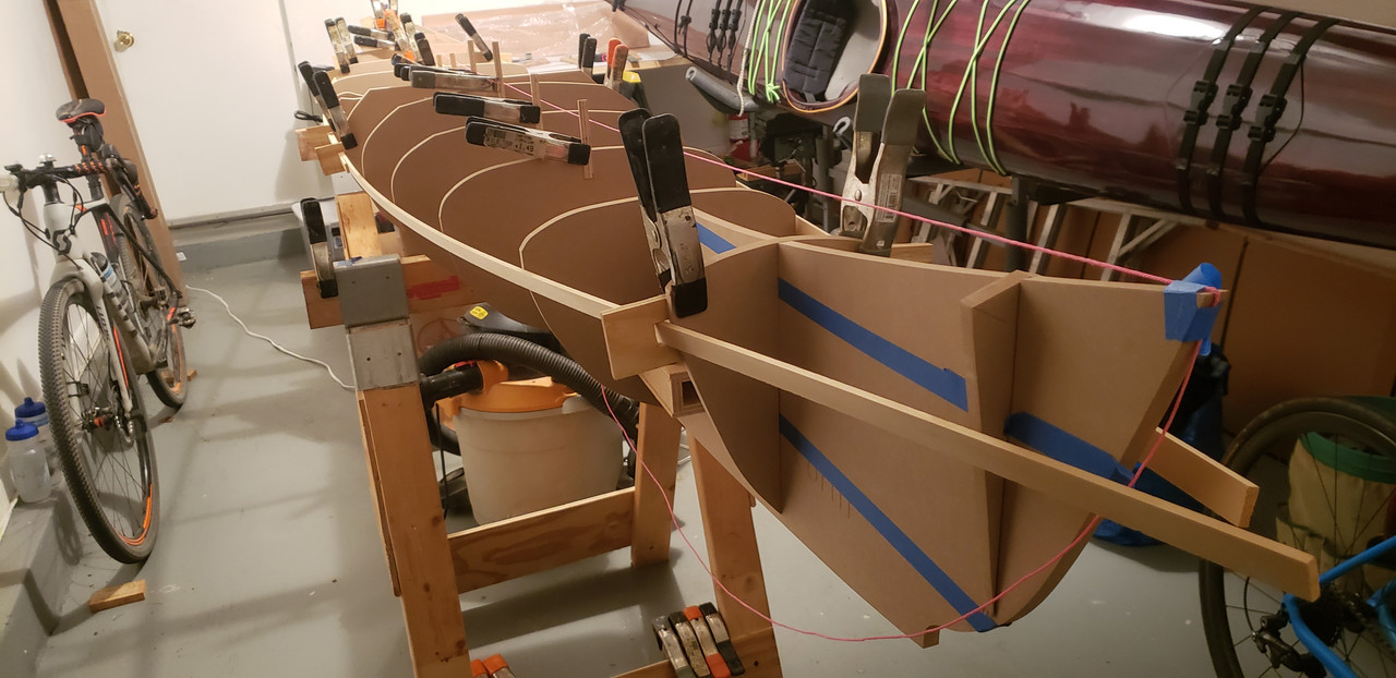

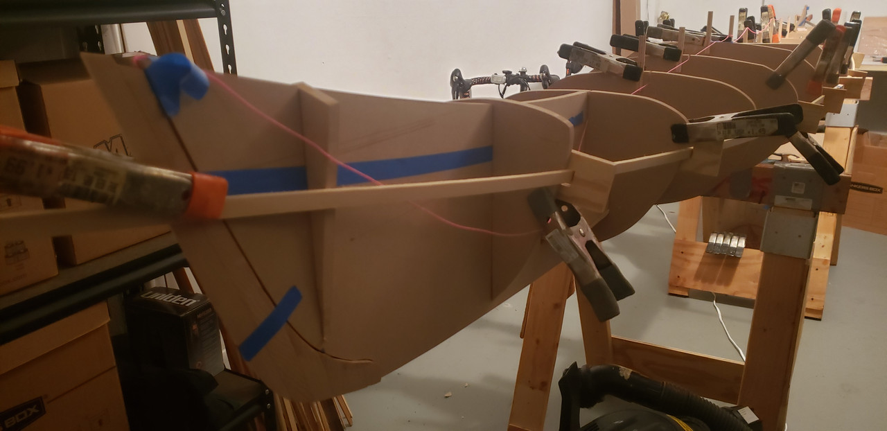

Pictures below are from my Mystery build.  In that kit, the stem templates are not precut but the outline is CNC cut into the bow/sterm forms.  I highlighted the line with red margic marker.  2nd and 3rd pictures are the hardwood stems in place.
