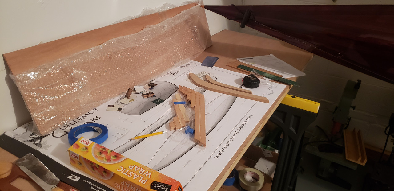

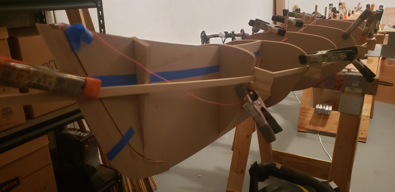

in the first two pictures below of the more recent kit, the inner stem pattern was already cut out of the end piece. the inner stem patterns are close to the tape measure and then in the following picture, you see how the pattern mates to the end piece.:
in an older kit, in the picture below, the inner stem pattern was also 'duplicated' and included in the end piece and needed to be cut out of the end piece to fit properly
fwiw, it was pretty confusing.....but i did sort it out. of course a couple pictures and quick post here or call to CLC and they can get it straightened out if my pictures and commentary didn't crystalize it for you.
do remember that the MDF is just a pattern for the inner stems....and you have to make a proper wooden inner stem for the boat.
good luck and i hope this was helpful.

one other way to tell if its duplicate or additional. if you put the pattern of the inner stem on top of the larger end piece and the outer edge matches up perfectly, it is highly likey that you need to cut it out of the underling end piece (last example above)
if they fit together like a puzzle piece (and does not have the characteristic above), then you are likely adding the inner stem to the end piece (first two pictures)
