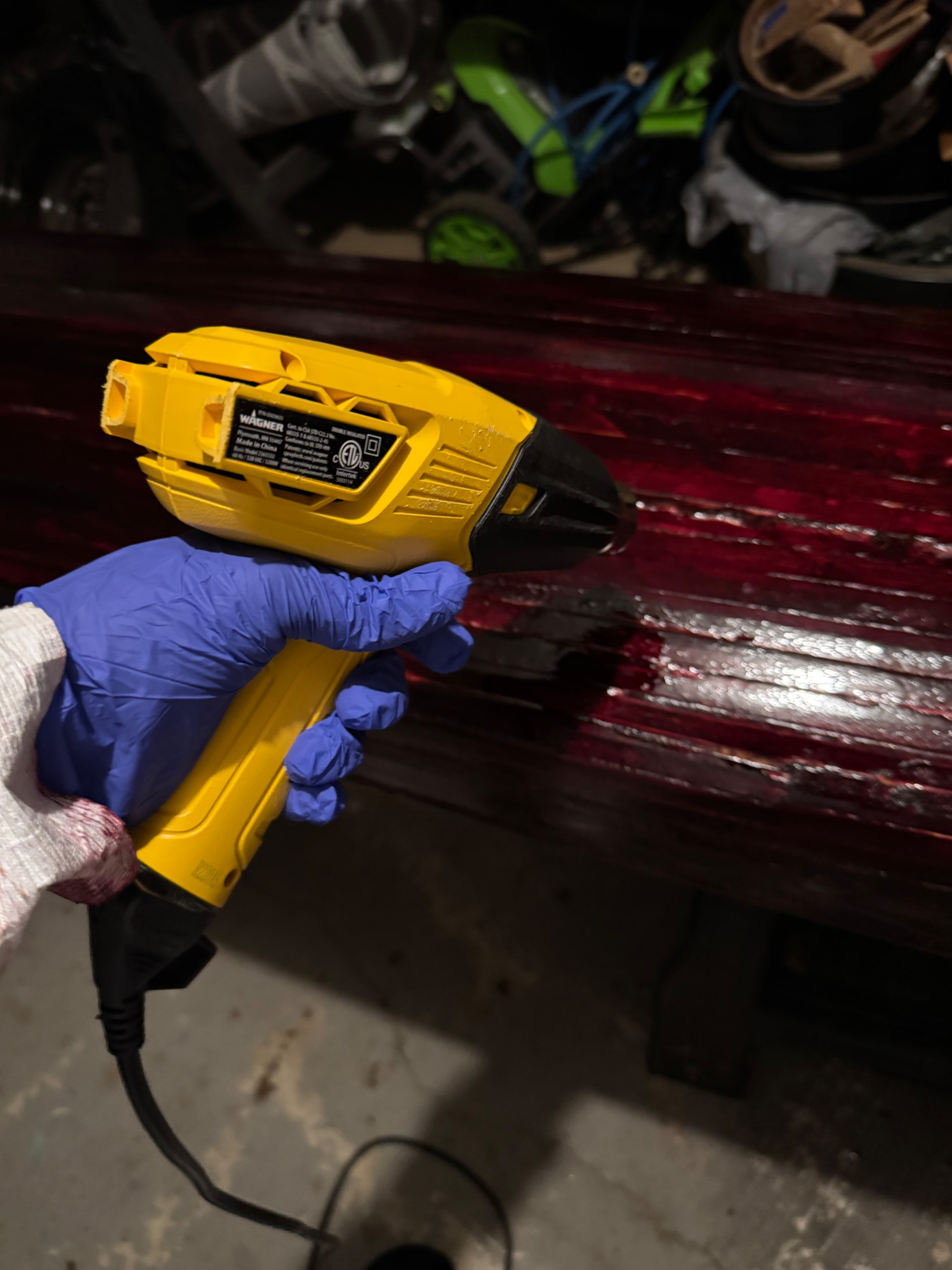

I don’t have a propane torch, so here is my attempt to heat the surface to bring any bubbles to the top to pop.

on your other question about heat/using a torch. the purpose of the skim coat is two part. the irst part is to fix the stain in place. the second part is to close the outward facing pores of the wood so that when the glass layer is applied,the underlying wood is sealed and you now can be less concerned about bubbles developing. so a heating like your doing is nice but not really necessary. that said, i would always do my skim coat into level or slightly decreasing temperatures. glass can go on as soon as the skim coat is set…i usually wait a day or two. and nothwithstanding that it fills the pores, i always, as a matter of discipline, do glass work into level or slightly decreasing temperatures if i am in any phase that i am glassing or applying epoxy to wood that has not been glassed yet.
