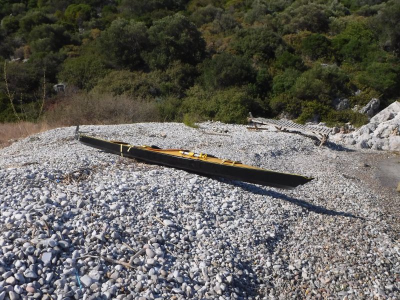

All stony/rocky beaches around here in SW Turkey (the picture is typical)so on all of my boats I put thicker fibreglass on the bottom than called for in the plans. The little extra weight is of no consequence. Like Laszlo, the bottom of my C17LT is coated with graphite and that has helped but after having to do a bit of repair on the bow I never run straight into the beach nowadays but come in parallel. I have a strip of Kealeazy on there now.
I haven't put graphite on the bottom of my WD14 as that is usually used with the sail rig and it's a lot easier to jump out a couple of metres from the shore but it still has heavier fibreglass on the bottom.
