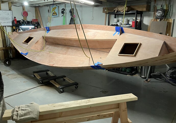

Aside from the rails and an eternity of finishing, the basic kit is now in the boat. I’ll be ordering the spacered inwales and probably the sailing kit at the same time to combine shipping.
There’s still a part of me that doesn’t believe I’ll ever get this boat launched.

Yep, I browse the Southwester Dory gallery on the CLC site pretty often. I really like that photo. I believe it was taken in Port Townshend WA, one of my favorite places I’ve ever been. When I lived on Bainbridge Island WA I was more into bicycles and motorcycles than sailing. I’d love to be there now. Puget sound is too far to trailer to, but the Chesapeake is close enough for long weekend trips. I’m already daydreaming!
sanding, sanding, sanding, sanding…
I’m doing a mostly painted finish so I’ll be able to let go of some things I would otherwise have to obsess over. Like where I whacked the aft bulkhead with the saber saw blade when I was trimming the deck; I had to fill in the wound so the router bit had a smooth and even surface to run along. Or where I sanded through the veneer in a moment of inattention. I do want the fillet radii to be as smooth and fair as possible so they look good painted, but I’m going to have to stop short of perfection if I want to sail her this summer.
I think I’ll end up having used twice the epoxy that comes in the kit, and half of that I have sanded off. Live and learn I guess.
Really hoping to do the next turn and work on the bottom this weekend. Also ordering the sailing kit today. It will be nice to have some bench projects do when I can’t take anymore sanding.

I still have a fair bit to do on top before it’s ready for paint, but I decided to do the next turn and work on the bottom now. It’s interesting to see after all this time the work I did in the very beginning when I really didn’t know what I was doing. I’ll have a lot to do getting the bottom shaped up, but nothing that can’t be done.
My sailing kit ships on June 3. I’m out of town this weekend, have race committee duties the following, and the week after that I’ll be volunteering at my kids’ sail camp. Work will be spotty, but progress will continue.
