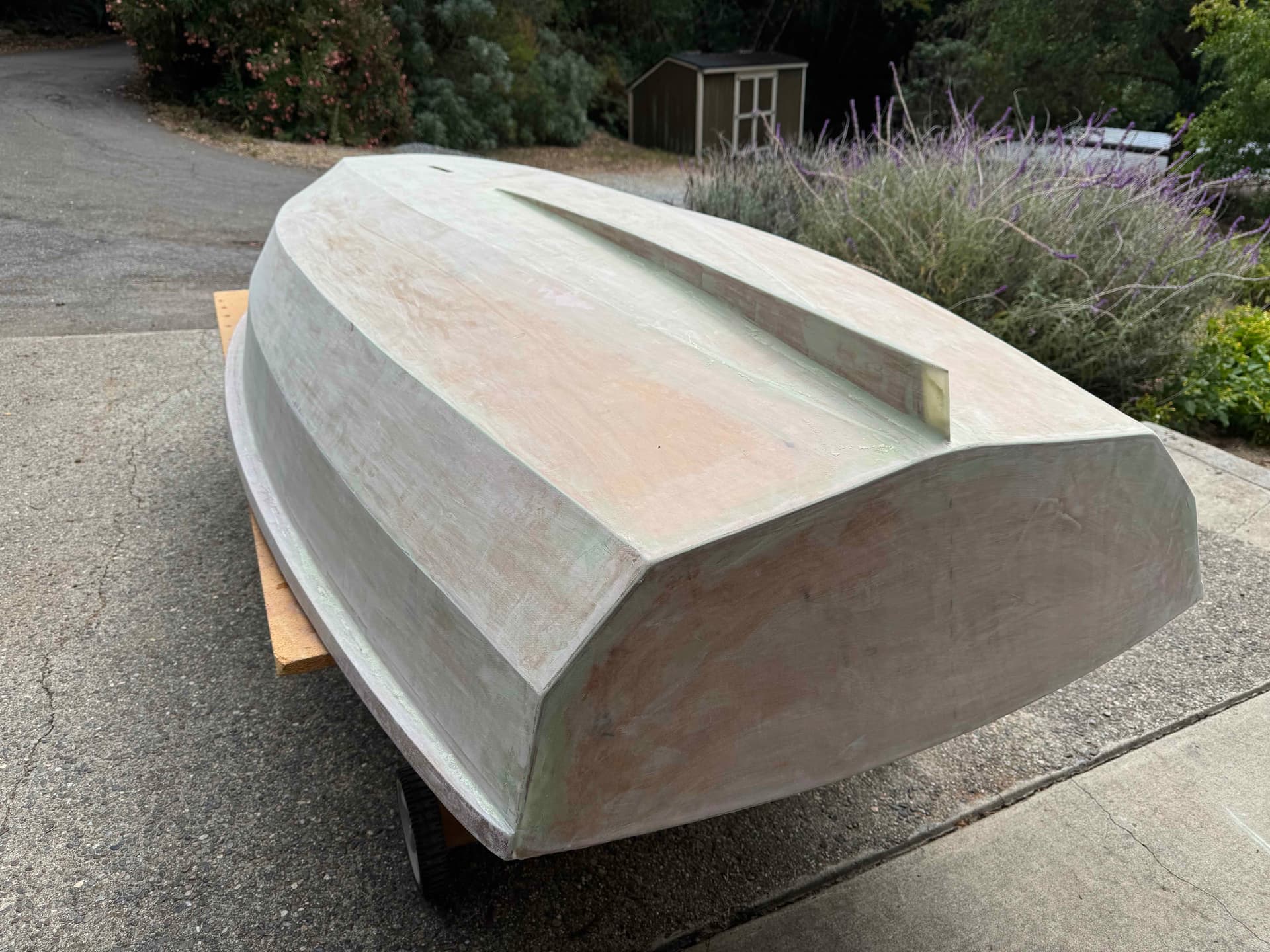

While fairing the hull I was starting to sand into the fiberglass so I stopped and applied Total Boat TotalFair compound. Wow, this stuff is great! It’s like Betty Crocker cake frosting, it made fairing so easy. It sands easy and applies with a drywall joint knife. Since the TotalFair was such a success I added 2 coats of TotalProtect barrier coat/primer with a 10% thinning. It went on great and made a very nice surface for the final paint. Warning: TotalProtect with thinner melts cheap foam brushes!

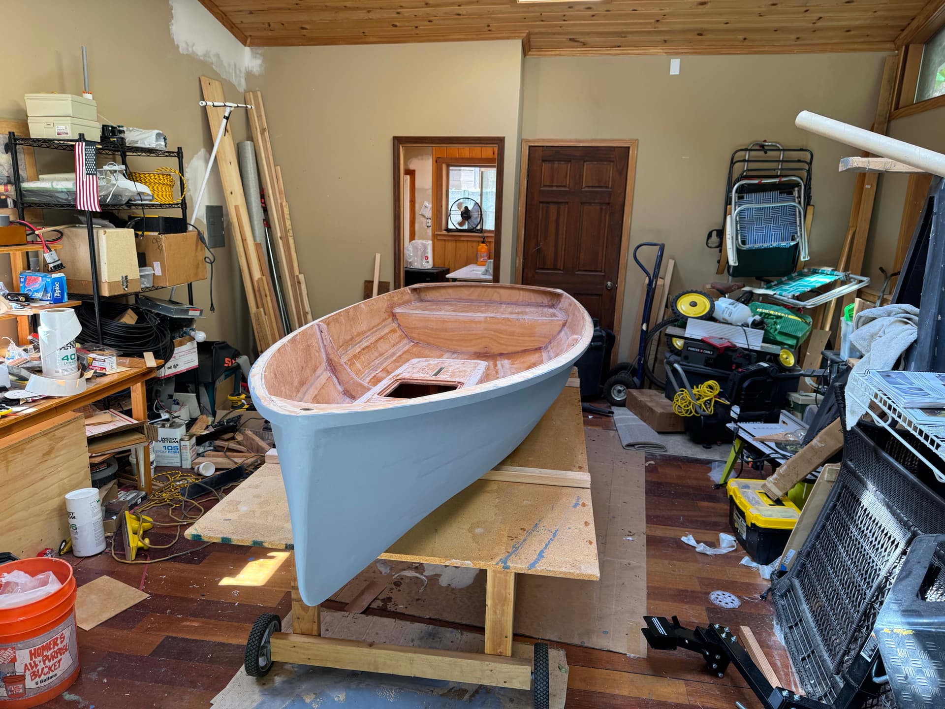

The hull after fairing. Green is the TotalFair compound. The hull came out very smooth, I’m super happy with the result.
The boat is flipped back ready to finish up the inside. I made a cradle to hold the boat steady with some carpeting padding to protect the paint.
Front view. Yes, my shop is very messy. I can’t wait to get the boat out just to get the place cleaned up.

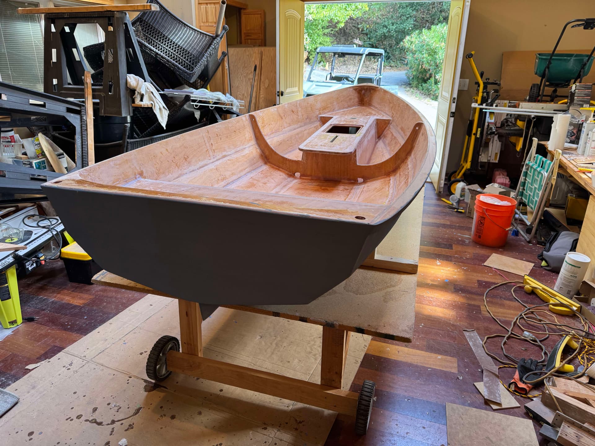

It’s been slow going just because I have been busy with other projects but the boat is getting close to putting in the water. I’m working on the oar lock risers and foot cleats now. Here are a couple more pictures.
I painted the outside of the hull with Total Boat Wet Edge thinned 15% using roll and tip. I did the first coat myself and it didn’t come out great and was hard to roll AND tip myself. For coats 2 and 3 I had a friend do the tipping while I did the rolling. Wow! that was much better.
