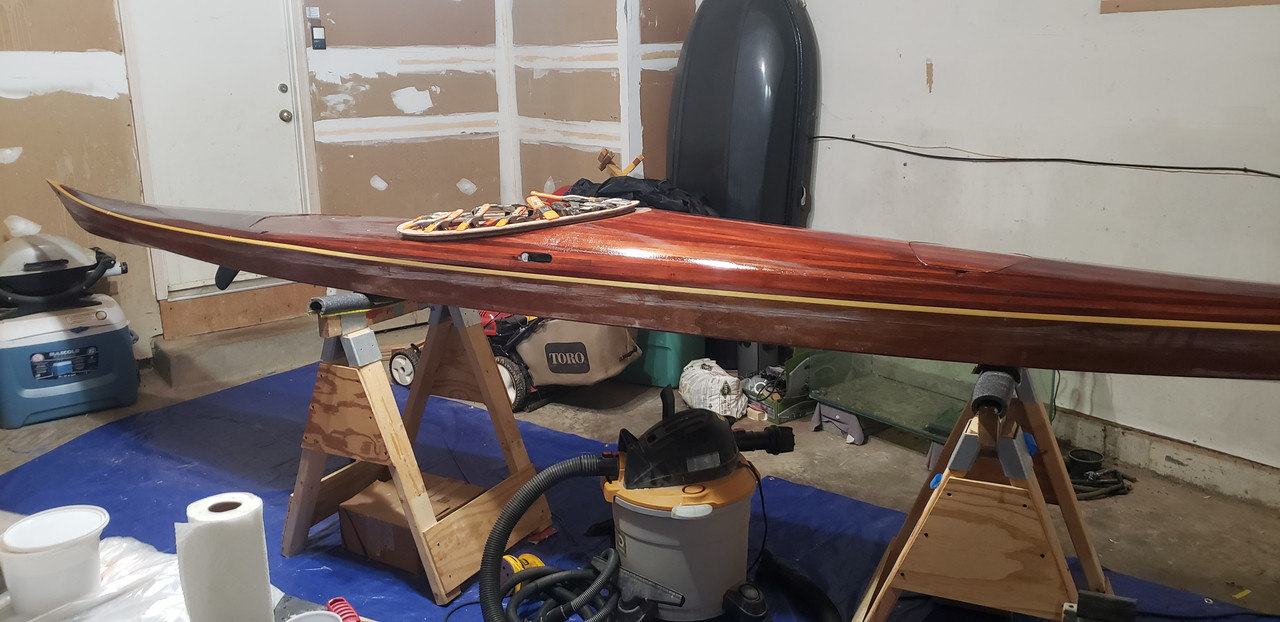

below is a picture of the coaming 'sandwich' being organized on the boat.  again, the bottom is the sill, the middle is the spacers/riser and the top is the coaming.
with respect to your question on looks, the interior of the marine plywood will be exposed.  i think it looks fine.  from the outside of the boat it is mostly hidden under the coaming rim so you don't really see it, from the inside i think it looks fine as well.
if you don't like the look you, can of course, make the risers out of cedar or some other material that you like.

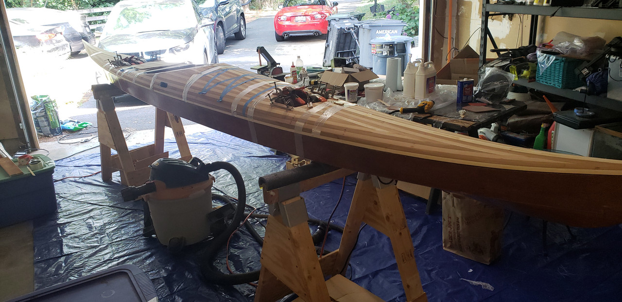

Anyway, I hope that answers your question and that you are doing well with your build and wishing you a happy new year!.  Am attaching a picture from about a month ago when we took the night heron out on the water here on the Potomac.

so below picture is now glassing the deck and overlapping it onto the hull (you can see the deck hatches being glassed at the same time in the background).

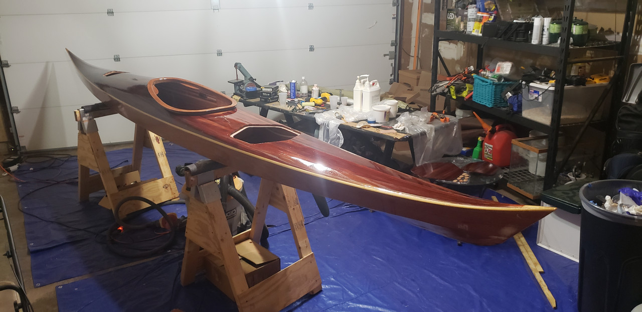

as i recall it now, i have, based on experience, determined that i liked having access to the underside of the deck to do real clean underside hatch work...that is just really tough to do once the hull and deck are mated.
the picture below shows doing the spacer and shelves -  but though this picture shows the deck on the hull, they had not been glued together yet.
the thing that i was trying hard to manage was the spring-back phenomenon i described earlier.  so while in the picture above, the hull and deck are not glued together, i did temporarily tape them so that when i glued the spacer and hatch to the hull, i would have them glued with the hull in the correct shape and not accidently  'lock-in' the springback that occurred (if it wasn't temporarily held in its final shape.  after this picture, i then seperated the parts again and nicely finished the underside of the hatches....before the 'permanent' glueing of the hull to the deck.
i hope that makes sense.  obviiously, another approach is to cut and do the hatch work after the deck is attached.....but like i said...its just hard to get a really good result for the below the hatches bits working blind....especially if the hatches are not particularly large.
