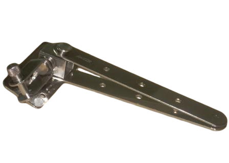

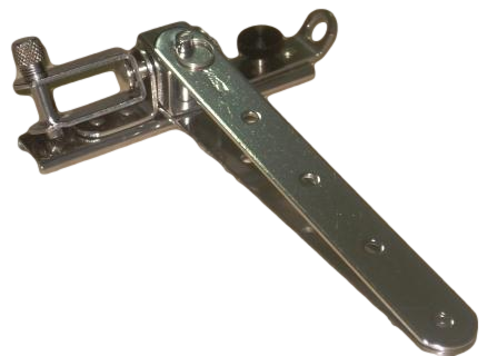

Is there a fundamental difference that I should be aware about before choosing a fixed mount boom pin style gooseneck vs. the strap mount fixed gooseneck that is similar to the style specified for the sliding yard?
Here's the recommended boom gooseneck:
Here's the alternative that I'm asking about:

The one I'm asking about attaches to the boom with straps, just like the slider.  That makes some sense to me, but I don't want to go against recommended hardware without a good reason.  Any thoughts?
   On the assumption that the pin type is not glued into the boom, the benefit there is that the boom slides right off the gooseneck when you are taking the rig down.  The strap types require you to undo the ring-ding (cotter pin or ring cotter) and remove the clevis pin to disengage the boom from the mast.  I think the strap types are more positive in that there is no chance for the boom to work back and forth, but that's not likely a real issue on a small boat like this with the sail hoisted.  I can see how, when you drop sail, the boom might slide off the pin, but I've never used one myself.  Of course that won't happen with the strap type.
The sliding gooseneck gives you the opportunity to rig a downhaul to adjust luff tenson on the main if you are the sort to worry about it.  It can help in brisk winds to adjust the draft on the main.  It does mean another string though (and probably a couple of blocks and a cleat).  You could do the same with a cunningham reef if you have the cringle for it on your sail, but that's more a big boat type of setup.

I bought one of each, so I'll let you know.  The good news is that they have the same bolt pattern, so I can try both.  I'm going to wait until I've made the sail so I can use the luff to help determine the spacing on the mast.  The one with the pin doesn't have the built in shackle to attach to the tack.  The one with the two tangs has a pin to easily remove the boom from the mast.

Oh, I forgot to add that they both swing about 15° forward of the beam on either side.
FYI, I decided to go with the one with the straps.  It has a built in shackle for the tack and is easily removable with a quick/fast pin.
