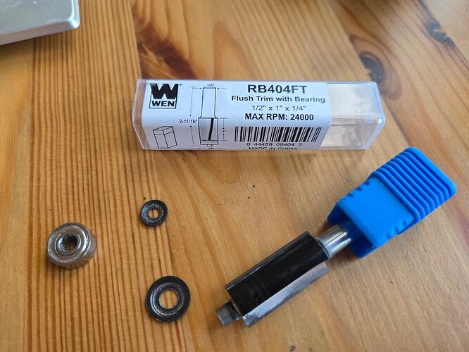

while cutting the daggerboard slot for my Passagemaker, the bearing broke off my “bargain” router bit (picture #1), causing me to mess up the slot (picture #2). Both seat and trunk are a mess.
Is there a recommended wood filler for a problem of this size? It would have to be pretty strong, workable and take finish.
I don’t think I’ve ever had any tool fail so fast - got the bit from Home Depot, successfully tested it on scrap then it fell to pieces on the first real usage.
