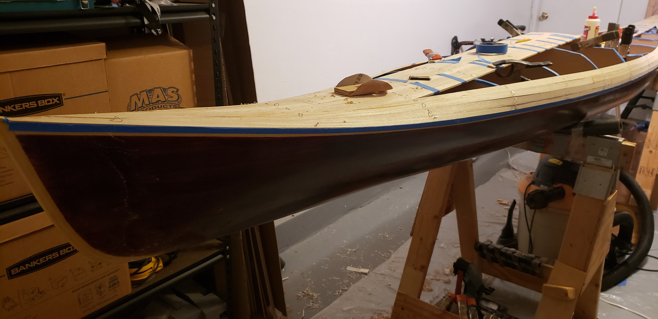

below is latest pic of a 14 foot boat i am working on with rectangular strips.  i would say at this point, the robo-bevel did about 30% to 40% of the bevels and the low angle block plane did 60% to 70% of all of the bevels.
