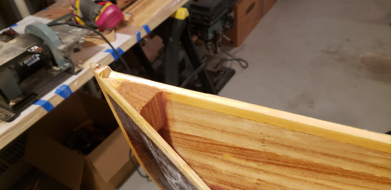

on your question about end pours.  if you have not already attached the hull to the deck, i would do your end-pour while you still have the boat apart.   your goal on the end-pour is simply to ensure that if you drill a hole for the a grab loop....that it does not open up/allow water into the boat.   you can make the end pour much smaller (and use less epoxy) by doing this prior to the placing the deck on.   and yes, you can also use micro-balloons (or even a block of wood) for end-pours....they are not structural.
in this approach, you would mark where you want your grab loop hole to be, then make/place a dam with scrap okoume covered in duct tape just outside the edge of the planned hole (i go only about another 1/2 behind the planned hole), and then make a thickened (peanut butter consistency) paste of epoxy and microballoons (you can also use woodflour) and trowel it into the tip of the boat with the dam holding it in place right at the ends.
below is a picture showing an end-pour (in this case wood epoxied into the end) installed into a hull prior to putting the deck on:

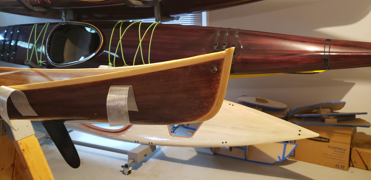

i then go ahead and actually drill the hole for the grap loop prior to assembly so i can confirm that the hole does not open up into the hull (see below)
