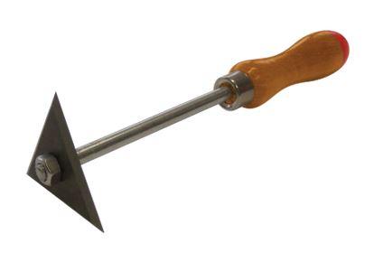

I'm still trying to figure out card scrapers. Meanwhile, I've been using a triangular paint scraper to good effect on glue and epoxy:
Nick Schade recommends using a rectangular one.
