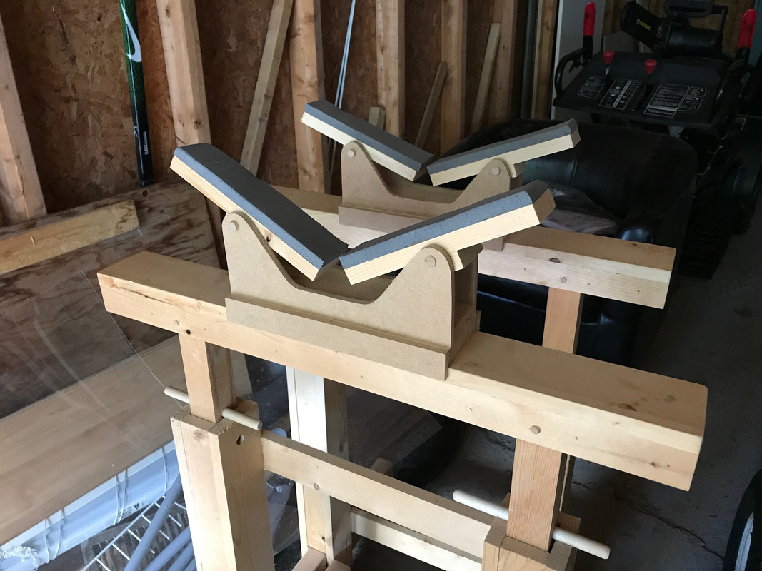

I built a pair based on this plan.
https://www.finehomebuilding.com/2007/03/01/adjustable-height-sawhorse
Adjustable height was important to me. Because of tight workshop space I wanted enough height that I could clear the top of the table saw with the kayak so I made the height adjustable from 30 to 40". I made the top support 24" wide.
I added lockable wheels and removable kayak cradles. It worked great, but in hindsight I'd have made the base a bit wider. I had to be careful moving it around at full height. I never tipped it over but it was always a possiblity.
Here's how the cradles look. They're held in place by a couple of dowels inserted into the cross beam so they can be easily removed.
