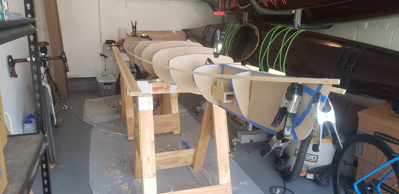

here is the sheer strip made from a single strip that was constructed by scarfing two 8 foot pieces together.
the next strip, the horizontal reference was made with similar construction:

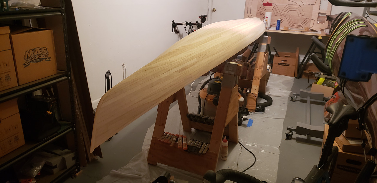

all the other joints are easy to fabricate butt joints that work great and are easy....and as grumpy pointed out are staggered:
