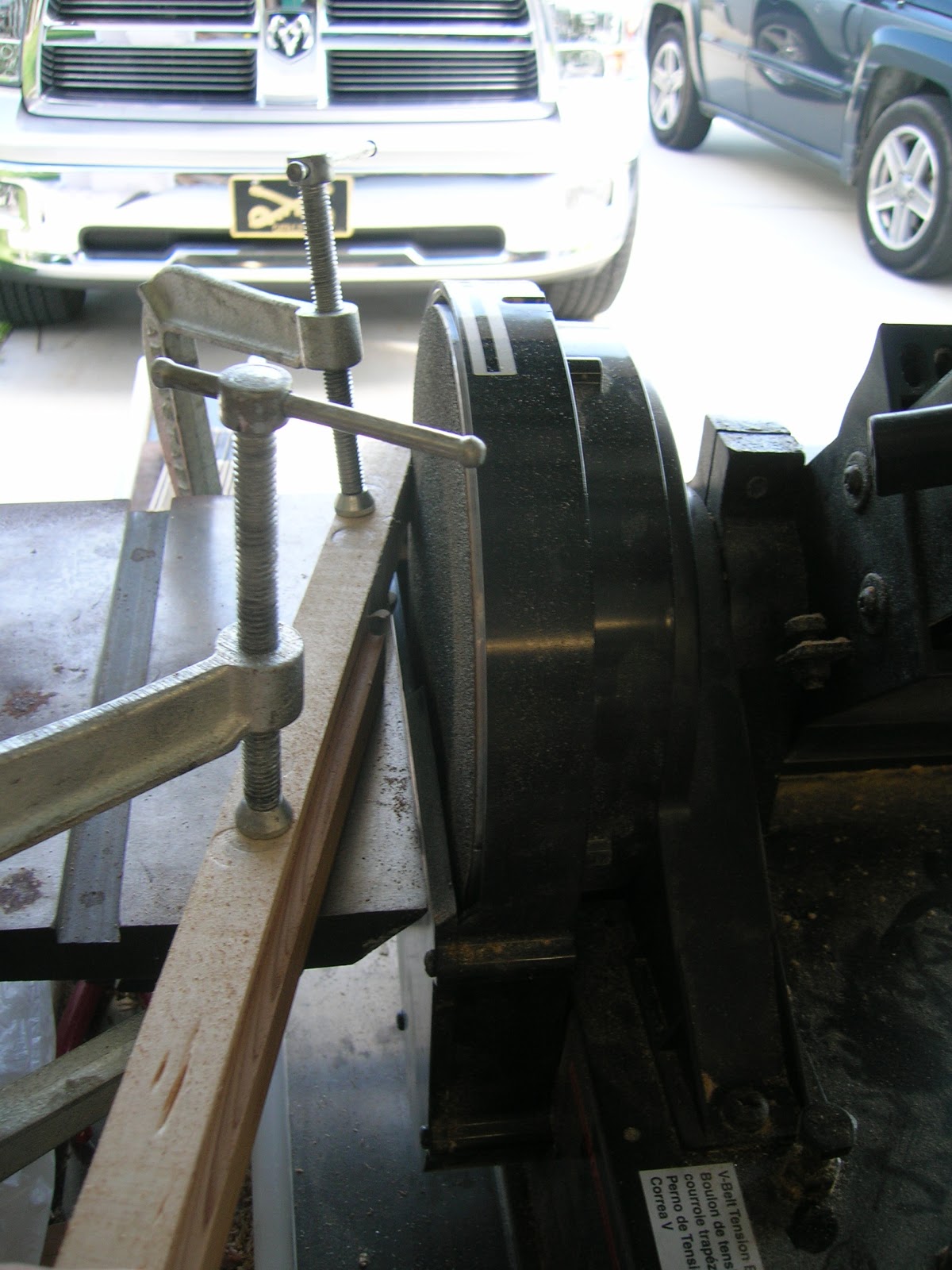

I used a sanding station disk with a 1 to 7 ratio scarf joint. I used a board as a straight edge clamped to the little sanding disk table at the 1 to 7 ratio.
You can also create your own little miter box to duplicate the 1 to 7 angle cut.
